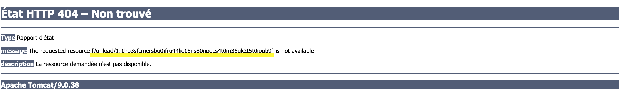

We have a scout application in production. When a user left his browser window after a certain amount of time without disconnecting, his session expires. After logged in again, instead of redirecting the user to the last outline and page or the default outline, he is redirected to an error page at the URL:
 http://x.x.x.x:8080/unload/1:xxxxxx...
Note that the redirected URL point to the /ROOT context whereas the application is deployed to http://x.x.x.x:8080/scout-app ! .If he go back to application by typing the url in the browser Address Bar, the application default page appear with his session logged in.
Attached a screen shot of the error the error screen.
Does anyone has encountered a similar error? what can cause this error?

it happens after the session timeout. The message box appears. After reloading the page the login page appears (Scout login). After entering the (correct) login-credentials the HTTP 404 (Not found) message appears (see Seydou' screenshot). As Seydou described
appears in the address line of the browser (I am using Chrome). Deleting the part of the address starting with "unload..." the application and the last outline appears. We have to set any session-related properties.

thank you for the responses. We were able to reproduce and fix it: https://git.eclipse.org/r/c/scout/org.eclipse.scout.rt/+/179828
I don't know yet when the next builds are planned, but in the meantime, you can easily workaround it by making sure, that requests to /unload/ won't be forwarded to the login page.
Just adjust your code in your UiServletFilter in the following way:
if (req.getPathInfo().startsWith("/unload/")) {
  resp.sendError(HttpServletResponse.SC_FORBIDDEN);
  return;
BEANS.get(ServletFilterHelper.class).forwardToLoginForm(req, resp);
@Nils: I suggest you replace your workaround with the above one, because I think the legacy fallback won't work for modern browsers, so your app probably doesn't do a proper unload anymore.
