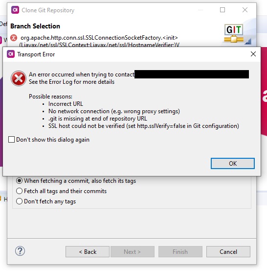

I downloaded the latest egit plugin 5.10 (Git integration for Eclipse 5.10.0.202012080955-r (org.eclipse.egit.feature.group 5.10.0.202012080955-r), tried to clone a repo, and got the Trasnport error (please see screenshot).
I downgraded it to 5.9 ( Git integration for Eclipse 5.9.0.202009080501-r org.eclipse.egit.feature.group Eclipse EGit), then was able to pull, which leads me to believe that there is some code difference / configuration in 5.10 that's causing this.
I don't even know how to start troubleshooting this. Where / what can I check?
Thank you for your help in advance.
May
  • Attachment: image.jpg
    (Size: 76.30KB, Downloaded 1019 times)
Re: Unable to clone repo in 5.10 [message #1836899 is a reply to message #1836871] Mon, 18 January 2021 05:17 Go to previous messageGo to next message
For one, there should be exceptions with stack traces in the log. What do they show?
What Java version is your Eclipse running with?
What does the full error message shown in the "Clone Git Repository" dialog say?

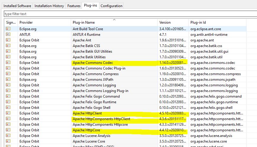

Re: Unable to clone repo in 5.10 [message #1836915 is a reply to message #1836913] Mon, 18 January 2021 10:30 Go to previous messageGo to next message
index.php/fa/39746/0/Actually there are 2 versions of the http client..?
  • Attachment: Capture.JPG
    (Size: 29.20KB, Downloaded 888 times)
Re: Unable to clone repo in 5.10 [message #1836916 is a reply to message #1836915] Mon, 18 January 2021 10:47 Go to previous messageGo to next message
Thanks a lot! That confirms my suspicion. I've opened bug 570451 for this. Once that wrong lower bound in JGit is fixed, it should pull in httpclient 4.5.10 and httpcore 4.4.12 (and commons.codec 1.14.0) automatically when JGit is installed. (If no httpclient 4.4.x and httpcore 4.3.x exist already.)
Don't know where the 4.5.10 version comes from, I guess nothing uses it since you don't seem to have httpcore 4.4.x.
Re: Unable to clone repo in 5.10 [message #1836918 is a reply to message #1836916] Mon, 18 January 2021 10:55 Go to previous messageGo to next message
Just to clarify...
I've had a look at all the ones that you mentioned, I do actually have httpclient 4.5.10, httpcore 4.4.12 and commons.codec 1.14.0
Does it look like I have everything that I should need but it's still not working somehow?
index.php/fa/39747/0/
  • Attachment: Capture2.JPG
    (Size: 128.70KB, Downloaded 1011 times)
Re: Unable to clone repo in 5.10 [message #1836921 is a reply to message #1836918] Mon, 18 January 2021 11:55 Go to previous messageGo to next message
Hm. JGit mistakenly claims it was happy with any httpclient in the range [4.3.0, 5.0.0). It isn't, it needs at least httpclient 4.4.0. Perhaps the OSGi framework wires it to use the 4.3.6 httpclient even though the newer version 4.5.10 is also available.
I don't know what could be done to resolve this problem except fixing this wrong lower bound in JGit and then installing an EGit nightly that has this fixed JGit.
A work-around that side-steps this problem is to switch the HTTP client in the EGit preferences from Apache to JDK.
Re: Unable to clone repo in 5.10 [message #1836923 is a reply to message #1836921] Mon, 18 January 2021 13:46 Go to previous message
EGit nightly contains a fixed JGit now. I just installed it into an Eclipse Neon.3 and got EGit 5.11.0.202101181758 and JGit 5.11.0.202101181723, as well as the correct Apache bundles, and JGit uses the new Apache bundles and can clone via http using Apache HTTP.
