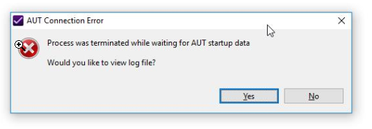

Re: RCPTT 2.5.1 couldn't start AUT based on eclipse (4.18) 202012 [message #1840647 is a reply to message #1836026] Wed, 21 April 2021 06:31 Go to previous message
we have an AUT based on 2020-03 and Java 11.
Application starts ok when outside of RCPTT.
RCPTT fails to start AUT with no log
"Process was terminated while waiting for AUT startup data"
