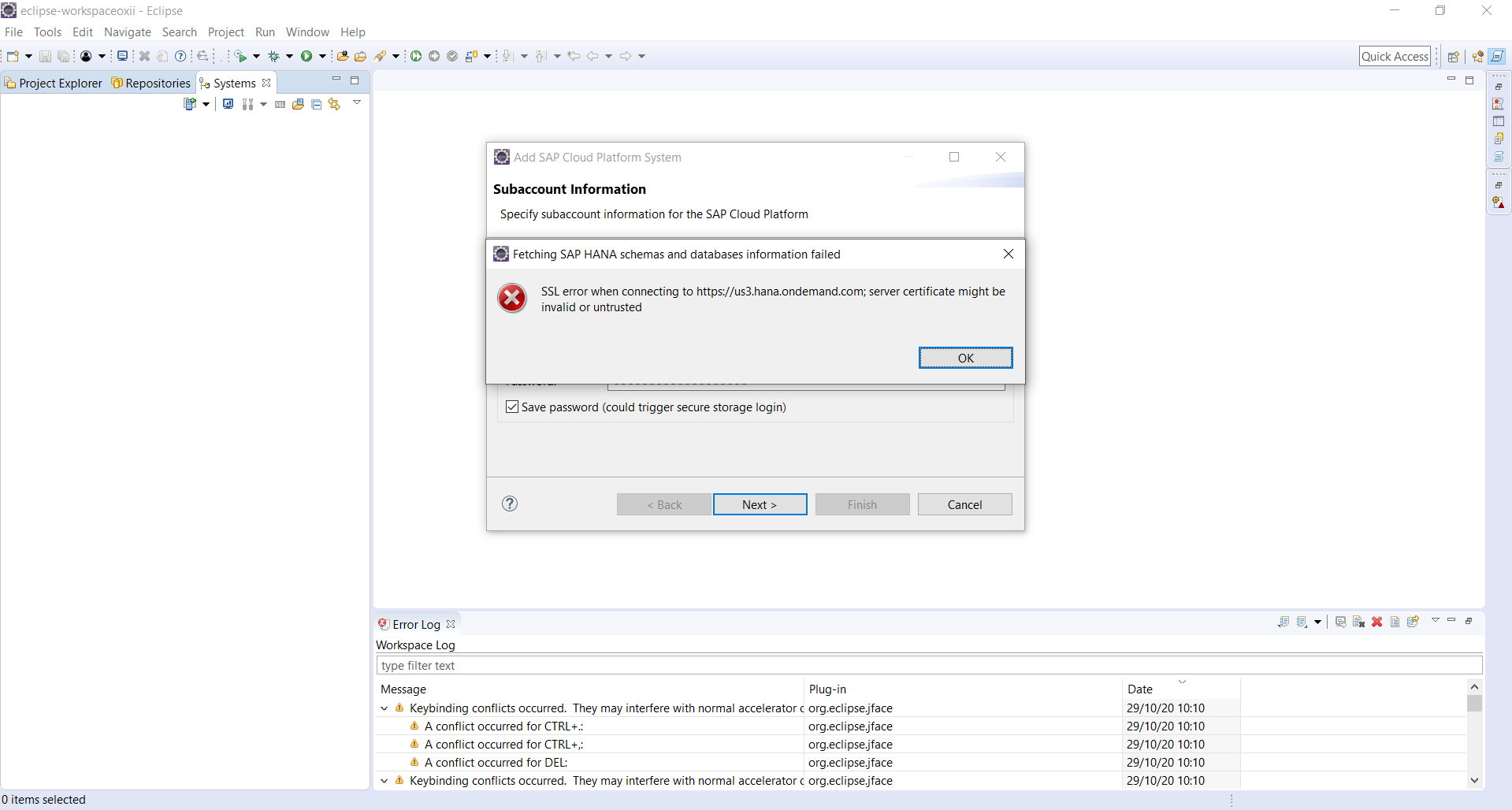

I am trying to add a cloud system from Eclipse, but when i enter the parameters i get the following error: Eclipse SSL error server certificate might be invalid; server certificate might be invalid or untrusted.
  • Attachment: Capture.PNG
    (Size: 99.42KB, Downloaded 164 times)

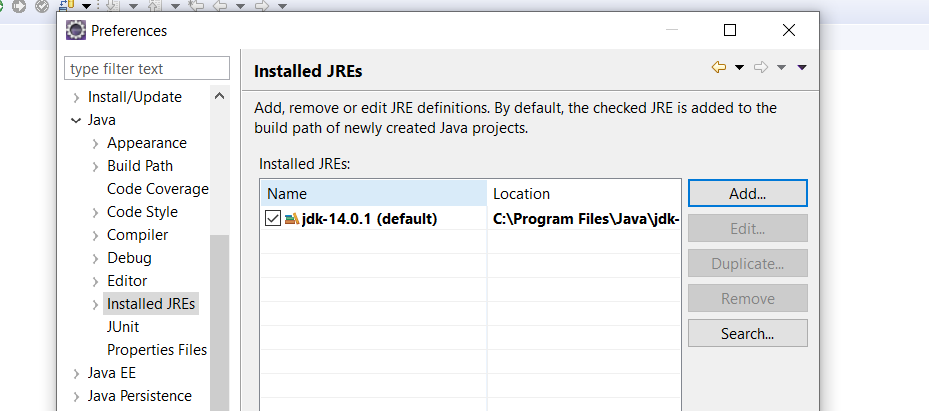

This could be caused by running the IDE with an older JDK/JRE that does not have a corresponding root certificate for Eclipse's newer site certificate. Which JRE/JDK version is your IDE using?
Re: Eclipse SSL error server certificate might be invalid [message #1834029 is a reply to message #1834008] Fri, 30 October 2020 09:43 Go to previous messageGo to next message
Hello, thank you for you help,
I am using JDK 14.0.01
I attach the screenshot
Re: Eclipse SSL error server certificate might be invalid [message #1834114 is a reply to message #1834029] Mon, 02 November 2020 16:11 Go to previous messageGo to next message
That page only controls which runtimes your applications are compiled and runnable
against, not which one is running Eclipse--and that's the one that matters. You can use
the About dialog's Installation Details' Configuration tab to make certain which one it
is.

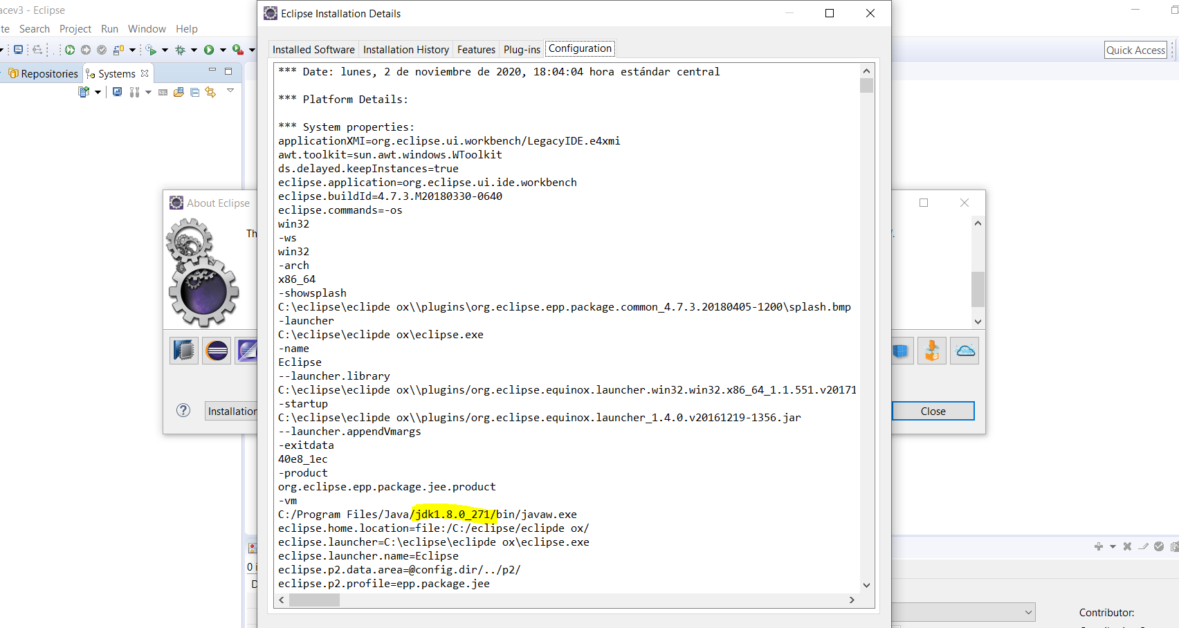

Re: Eclipse SSL error server certificate might be invalid [message #1834116 is a reply to message #1834114] Mon, 02 November 2020 19:07 Go to previous message
Hello
this is the JDK1.8.0_271
I attach a screnshot of the configuration tab
  • Attachment: Capture10.PNG
    (Size: 138.42KB, Downloaded 275 times)
