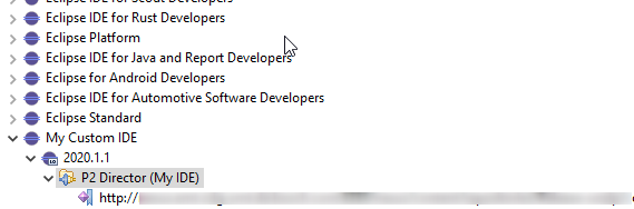

So I have updated the org.eclipse.products.setup file to list my IDE pointing to the P2 repository (I would have even created user setup file for the same)
index.php/fa/38724/0/

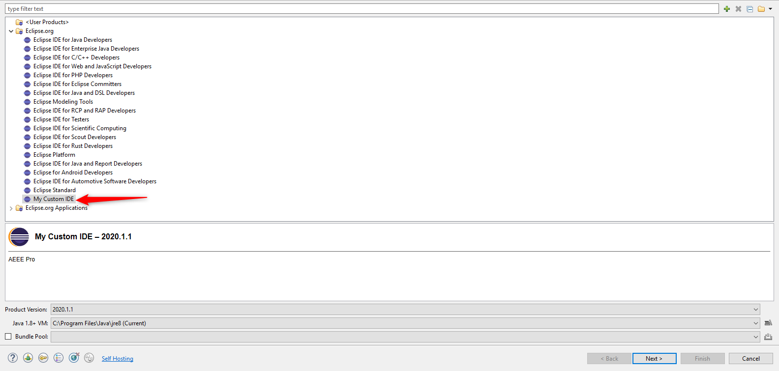

now my IDE is listed in the product list of oomph installer dialog.
index.php/fa/38722/0/
i have selected this product and installation finished without any errors, but many of the plug-ins listed in my repository are missing in the installation, hence i could not launch my IDE.

I don't see that your p2 director task has any requirements. I only see a repository, but if you don't specify what to install from that repository then nothing will be installed. You should look closely how the existing products specify their p2 directory tasks.

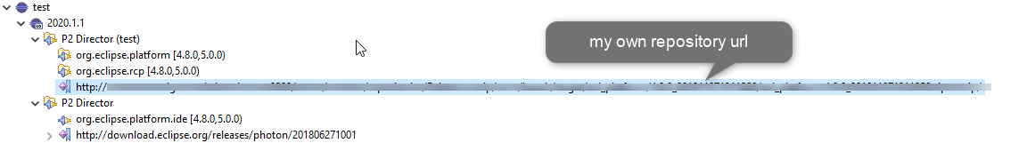

I have created two separate P2 director tasks and set "Merge Disabled" to true and installation worked as expected.
index.php/fa/38751/0/
Now the issue is configuration/org.eclipse.equinox.simpleconfigurator/bundles.info is NOT created.
This file gets created when I get all my requirements from
http://download.eclipse.org/releases/photon/201806271001
instead of my repository
so wanted to know in general, what is responsible for creating bundles.info or how this bundles.info is created ?
Re: install my own eclipse IDE [message #1830950 is a reply to message #1830938] Fri, 07 August 2020 04:09 Go to previous message
Perhaps its important to install the product first before installing additional features. So maybe just reordering the p2 Director tasks will do the trick.
