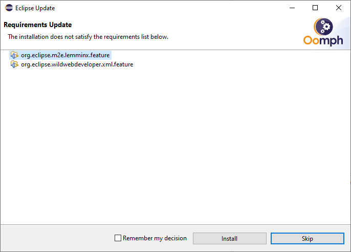

Also just had this interesting interaction:
Went to Marketplace, installed tab. Only listed Buildship Gradle Integration and UC Detector. Spotbugs is missing for some reason, CDT as well. They are working though.
Searched for groovy in the Search tab. "Groovy Development Tools 3.8.0.SNAPSHOT" has "installed" in cursive instead of Install. I click the button.
Brings me to the installed tab. Now "Groovy Development Tools 3.8.0.SNAPSHOT" is there, with an Update prompt. Spotbugs+CDT still not listed.
Groovy cannot be updated via the update dialogue, see attached picture. I assume it's because i'm using Java8 because of the licence issues with the later versions. Any ideas?
Or maybe another way: I wouldn't have a problem just installing eclipse again if you could tell me how to configure it so that auto-update actually works. As i said i'm already amazed enough the upgrade to 2020-06 went through and didn't leave eclipse in an unusable state, but if i could have that and have the small handful of plugins i use actually also update that would be really great.
I'm also unsure why there is a difference between the dialogue you get when starting up eclipse and the one you get via Help->Check for Updates. And if the Marketplace ties into any of that.

Re: Oomph cannot find .equinox.p2.iu and .jdt.feature.group [message #1828987 is a reply to message #1828976] Tue, 23 June 2020 12:30 Go to previous messageGo to next message
I can't know what you've all installed and which of those things depend on other things that are hence installed indirectly. I also can't comment on Groovy, but I see it has "patch" dependencies that typically lock in very specific versions of the thing that it's "patching", i.e., JDT...
In the picture it appears you are trying to install something with Java 11 dependencies, but you say you only have Java 8?
Auto updates do normally work, BUT, if you install a whole whack of things, and those things have strict version range restrictions, those things can prevent updates with failures exactly like what you've shown.
The Check for Updates looks at everything you have installed and at all the available update sites and checks if there is some "solution" that will allow new versions of something to be installed. The dialog that comes at the beginning does something similar, BUT, it looks also at the Oomph product catalog , i.e., the product version you installed. So, if you installed "Latest Release" and there is a new release, on startup Oomph will see you don't actually have the latest release already installed and will offer to try to install that eagerly. Given the things I pointed out above, it may not be possible to do that update.
