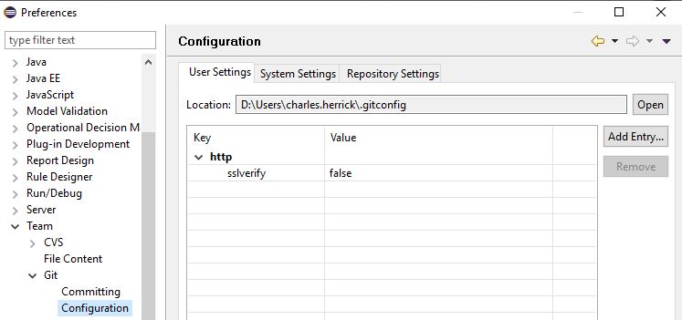

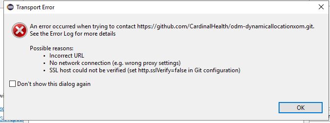

Egit :: clone repository takes my credentials and immediately throws the Transport Error (3 possible probs, url, sslVerify, etc). Git BASH clone works flawlessly. Any ideas on why Egit is being difficult?
Note: I do NOT have ssh keys set up.
Windows 10, Eclipse 4.4.2
Egit 4.9.2
Please see the attached .jpg files

- there is no need to setup ssh keys when cloning via https
- you should not disable ssl verification except for a short trouble shooting, if your JVM doesn't trust the server's certificate you should import its ca certificate to teach the JVM trusting this server's certificate authority
- are you behind a proxy and didn't configure Eclipse to use it or vice versa ?

This is a private repository at Github, so I can only guess at what might be wrong.
Do you have 2FA enabled for https access? If so, the password would have to be the access token. See the Github documentation.
Also, EGit 4.9.2 is rather old; there have been some improvements since then. Try cloning from an Eclipse 2020-03 with EGit nightly installed (update site: https://download.eclipse.org/egit/updates-nightly ). Does it work then?
Are there any errors in the Eclipse log? If so, it might also help to see what they are.

I do see in the .metadata\.log file the error "cannot open git-upload-pack"

Please show the stack trace of that "cannot open git-upload-pack" error, as well as any other error in the log that looks like it might have something to do with this. (Say, occurred a few seconds before.)
If this is an old Eclipse, it may also be using an old JVM. I know that IBM ships its own JVM with RSA (Rational Software Architect), and it is outdated; if that JVM has outdated certificates then perhaps the SSL connection already fails.
Proxy settings in IE (which I guess is Internet Explorer) should have no effect in Eclipse? No proxies in Eclipse are set? Opening a Github page in the Eclipse-internal web browser works?
Did you try using a modern JVM (AdoptOpenJDK 11.0.7 or newer), a modern Eclipse like 2020-03 and a modern EGit like EGit.nightly? It is worth a try, because if that works we know that either it's a fixed bug in EGit/JGit, or it's indeed an outdated JVM. And if that still doesn't work we know we have to look elsewhere.
Re: Transport Error :: Egit :: clone repository fail [message #1826422 is a reply to message #1826418] Fri, 24 April 2020 12:22 Go to previous messageGo to next message
Just remembered: if your Eclipse is using an IBM JVM, it might also be bug 558709.
If you are using an IBM JVM, try setting "-Dcom.ibm.jsse2.overrideDefaultTLS=true" in eclipse.ini.

stack from "cannot open git-upload-pack":
Eclipse warns about the HOME variable and then
!ENTRY org.eclipse.egit.ui 4 0 2020-04-24 08:41:49.291
!MESSAGE https://github.com/CardinalHealth/odm-dynamicallocationxom.git: cannot open git-upload-pack
!STACK 0
org.eclipse.jgit.api.errors.TransportException: https://github.com/CardinalHealth/odm-dynamicallocationxom.git: cannot open git-upload-pack

Caused by: javax.net.ssl.SSLException: Received fatal alert: protocol_version

OK. You are using an IBM JVM, and this looks like bug 558709.
So try setting "-Dcom.ibm.jsse2.overrideDefaultTLS=true" in eclipse.ini first.
And/or remove that http.sslVerify=false git config.

http:sslVerify=false removed.

Well, "git-upload-pack not permitted" is something else. "cannot open git-upload-pack" really was http.sslVerify = false on an IBM JDK.
So try again http.sslVerify=false, but leave the -Dcom.ibm.jsse2.overrideDefaultTLS=true line in eclipse.ini. I'd need stack traces again to be sure, but if that combination works, then it's outdated certificates in the IBM JDK you're using.
If it then still doesn't work, I'm a bit out of ideas. Except trying it with a modern Eclipse/EGit combo.
