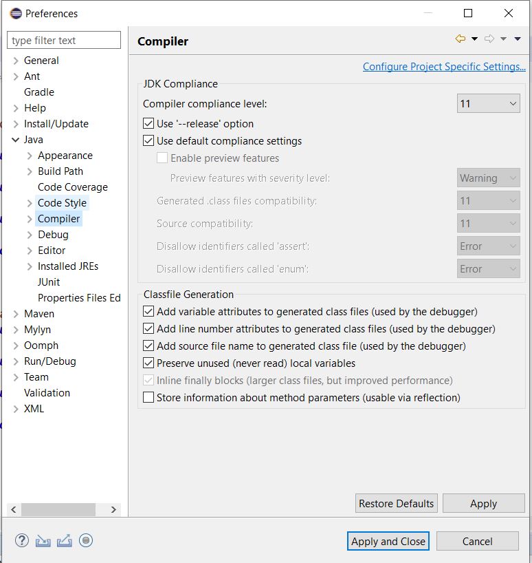

Re: Error: LinkageError occurred while loading main class [message #1827626 is a reply to message #1826177] Tue, 19 May 2020 09:51 Go to previous message
Change Compiler compliance level from 12 to 11
  • Attachment: Capture.JPG
    (Size: 99.22KB, Downloaded 961 times)
