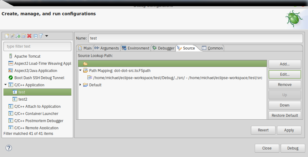

A half fix is to add both "File System Folder" of "/" and a "Path Mapping" to the debug configuration for the source.
This works when adding a breakpoint with the GUI; however, when you start the debugging previously defined breakpoints still have the original issue. So each time you start debugging you need to remove all breakpoints and then add them back 8-(
