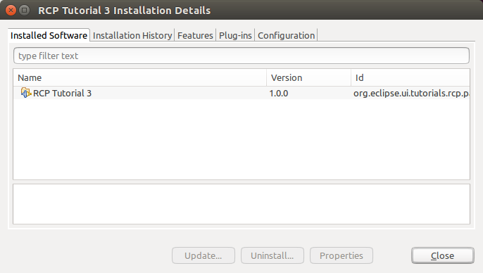

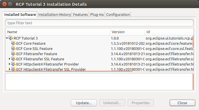

2 weird things I also noticed during my investigations, might be related or not...
In both cases the exported product seems to be incomplete (or not initialized?). Note that running eclipse -initialize after 1) didn't helped more...
Installed root UI
From r/w installation:
index.php/fa/35217/0/
From r/o installation:
index.php/fa/35218/0/

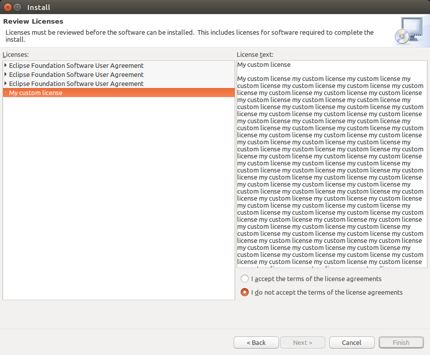

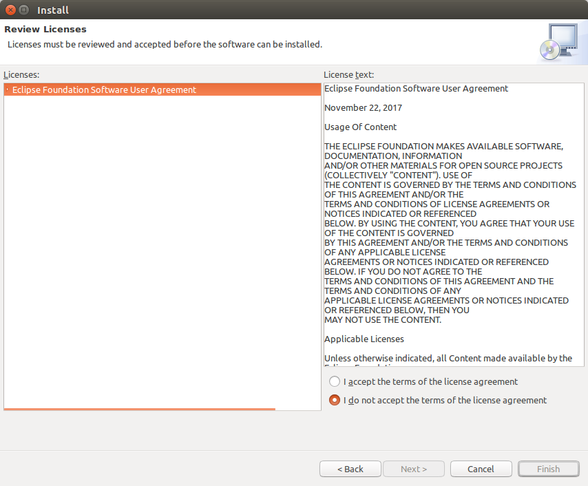

License review during install
index.php/fa/35215/0/
index.php/fa/35216/0/
What afraid me with this last one is that installation of product features seems not completely done since I have to validate the product's licences although this is not part of the current installation scope (Git integration for Eclipse)
