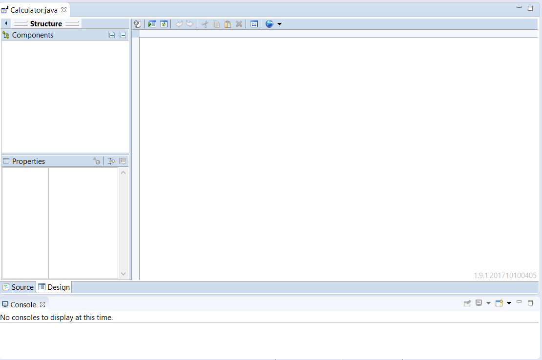

My windows builder design tab isn't showing my GUI, it's basically blank. I've tried opening new projects, updating & uninstalling windowsbuilder, the project is opened with windowsbuilder editor, but the thing just doesn't seem to be working. No online solutions that I've found have solved the issue.
I started on this project probably a couple months ago but closed it, I came back to finish it just now and it's doing this.
Additionally, when I go to layout assistant it says "Empty Selection"
Sorry about the file being a attachment can't link it or use BBcode because this is my first post.
  • Attachment: designtab.PNG
    (Size: 23.65KB, Downloaded 1715 times)

Does the "Source" tab display your source code?
Did you check the workspace log file?
Have you changed java versions in the last couple of months?
Did you try doing a "Clean"?

[menu] Project > Clean...
File ".log" in ".metadata" subdirectory of your workspace directory.
