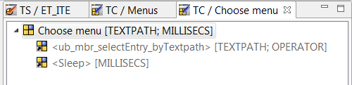

Re: Menu Bar Check sometimes clicks too early [message #1768054 is a reply to message #1768040] Thu, 13 July 2017 06:14 Go to previous messageGo to next message
Hi Alex,
you are right, menus are diffrerent.
I am not sure, if this helps, but if the problem is with some kind of refresh,
that means menus create big structures and their display and hide take some
time, slow down could help.
I had such problem when I used <ub_mbr_selectEntry_byTextpath>.
Action required from menu command sometimes did not executed.
When I call <ub_app_wait> after the menu action, everything started work correctly.
GUI was not able follow actions.
If I understand well and this is the problem, you can do the same I did:
create a module <SelectMenu>, put your command inside, add wait module,
all parameters that you want configure through dataset set as parameters,
and it could work.
Example of my user module is attached. Actually I use wrappers for all standard modules that I use in my tests.
Milos
