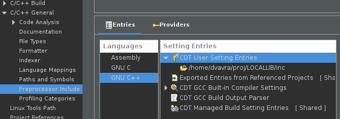

1) the Indexer, which needs to know where to look for header files.
I have a small utility library in $HOME/proj/LOCALLIB
I need to inform the indexer of where it is
Project --> Properties --> C/C++ General --> Preprocessor Include Paths, Macros etc. --> Entries tab
index.php/fa/29633/0/
The project also uses the openmpi library but it is found in the built-in include paths so it isn't necessary to additionally specify it.

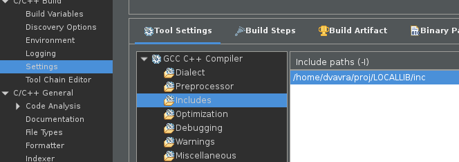

2) If Eclipse is generating the makefile, the compiler needs to know the locations of the headers
Project --> Properties --> C/C++Build --> Settings --> Tool Settings Tab --> compiler
index.php/fa/29634/0/
If you are generating the makefiles you will need to add the -I<header path> manually to the compile command

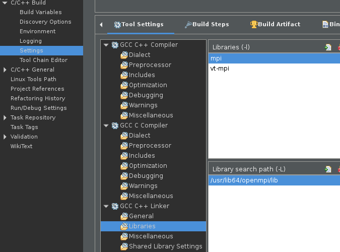

3) If Eclipse is generating the makefile, the linker needs to know how to find the library
Generally you would use Project --> Properties --> C/C++Build --> Settings --> Tool Settings tab --> linker --> Libraries to set the library path (-L) and library files (-l).
Here I use /usr/lib64/openmpi/lib/libopenmpi.so and /usr/lib64/openmpi/lib/vt-mpi.a
You should familiarize yourself with what these options mean to the GCC loader.

index.php/fa/29635/0/

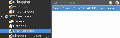

The library name for my local library doesn't follow the GNU conventions for library names so I can't use -l<name> (which is shorthand for lib<name>.<a or so> see the loader options links above). Instead I need to add it as a Miscellaneous --> Other Object
index.php/fa/29636/0/
Obviously, if you are generating the makefile you will need to add the options manually to the link command.
