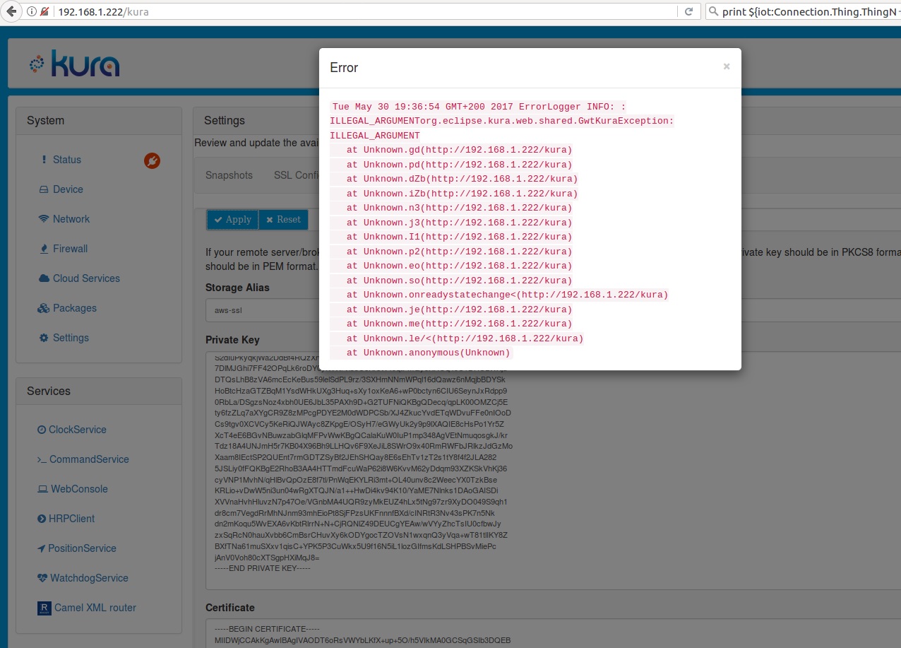

Now, I want to publish the data to the cloud, using AWS. I've been following the step by step guide on how to connect an Eclipse Kura™ device to the Amazon AWS IoT platform, but in step 8.
I get the following error:
* Image attached below since I can't post external links *
I know I have followed the steps correctly since it works fine when doing it in Kura emulation mode (Im getting this error in the Raspberry 3).
Im using kura 2.1.0. I attach below the logs that appears when clicking on 'Apply'.
¿Can someone lend me a hand?
Thanks in advance,
Javi.

Hi Javier,
did you have a look at this issue here? https://github.com/eclipse/kura/issues/1388
It seems similar to what you reported.
Matteo

Thanks Matteo for the fast answer. I have checked that and I have managed to solve the problem! The thing was that I had put as keystore '/opt/eclipse/kura/security/cacerts' instead of '/opt/eclipse/security/cacerts', I feel so dumb...
Thank you so much again for your help, really appreciate your work.
Javi.
