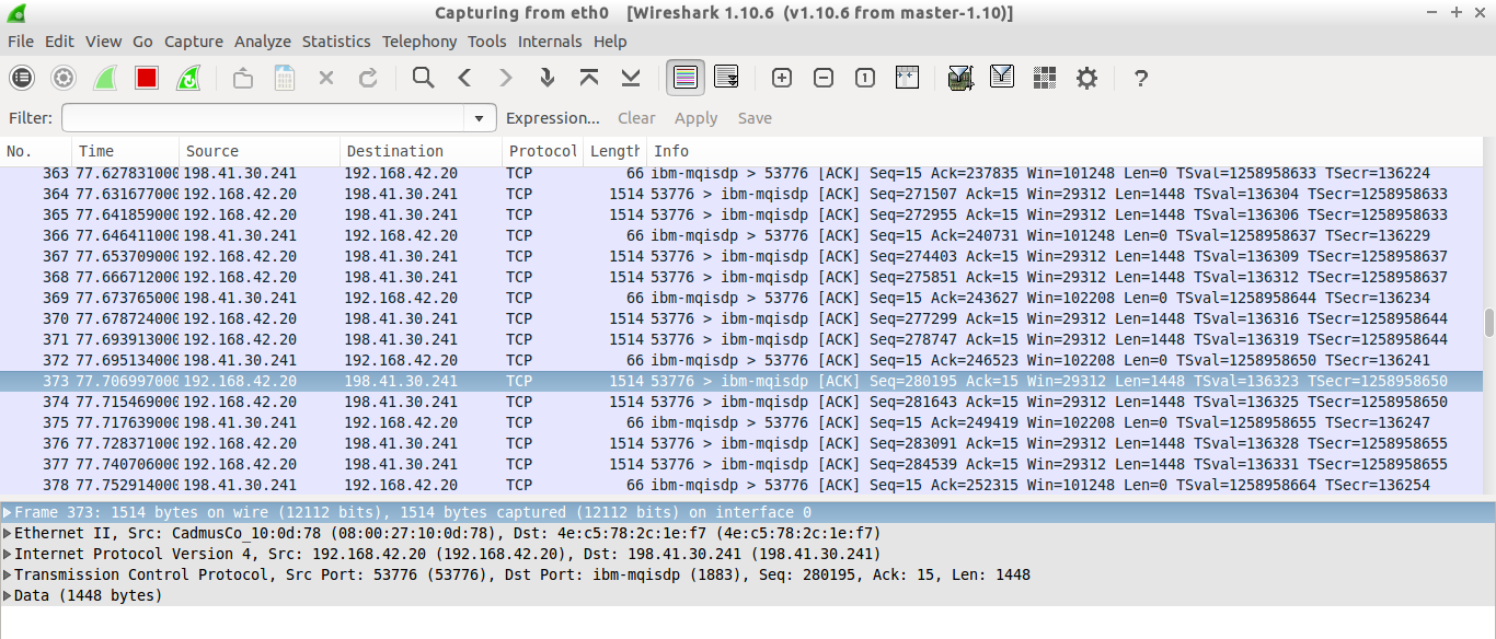

I am newly implementing Kura and I try the "Heater" demo example for publishing application. Now, I wanna make sure that Kura, with Heater demo publish apps, succeeded to sent the data to the broker and it's ready to be subscribed. i used mqtt://iot.eclipse.org:1883 for broker url in Kura web mqtt data transport configuration.
once i used mosquitto_sub ( mosquitto_sub -h iot.eclipse.org -t data ) for trying subscribe data, but the data from Kura won't showed.
i tried to check from publisher side use wireshark and the result like this [1]. this is looks like the data was sent from publisher, so maybe the problem is the way I subscribe.
So can anyone here help me to tell how to subscribe the data sent from kura ?? is it different from subscrabing in common way ?? or maybe somone here tried subscribe service in Kura itself so there is two client as Pubs and Subs are both using Kura ??

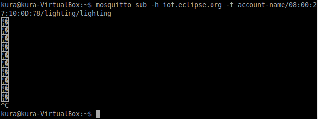

Thanks Pier for your helping, its really help me and I got the data that sent from my Kura. but i get the new problem now for data what i get.
the data I got showed like this [1], can you tell me what kind of that data i get from broker ?

Re: How to make sure that Kura's publishing data already sent [message #1761370 is a reply to message #1760986] Wed, 10 May 2017 05:31 Go to previous messageGo to next message
indeed the results is not so readable Smile
The messages Kura sends to the broker are encoded in a ProtoBuffer, so when you subscribe to a specific topic, you get a binary data.
BTW, in Kura 3.0.0 (coming soon), you will be able to encode the data in Kura messages also in a (more readable) json format.
