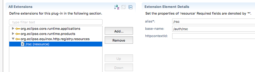

But this never works out. It does however, when I use the resp. extension point definition (see enclosed pic). I use Neon.2 as target and its contained bundles.
index.php/fa/28789/0/
I would really like to do it all as Whiteboard, what am I missing out???
