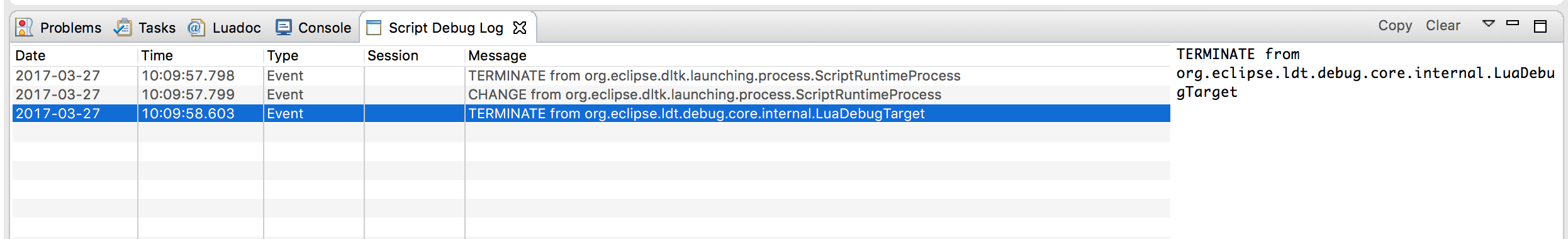

Re: LDT crashes immediately in debug mode [message #1756421 is a reply to message #1756391] Thu, 16 March 2017 12:07 Go to previous messageGo to next message
Script Debug Log view reads:
TERMINATE from org.eclipse.ldt.debug.core.internal.LuaDebugTarget
Re: LDT crashes immediately in debug mode [message #1758293 is a reply to message #1756421] Mon, 27 March 2017 05:52 Go to previous messageGo to next message
This is not the whole log, isn't it ?
Re: LDT crashes immediately in debug mode [message #1758318 is a reply to message #1758293] Mon, 27 March 2017 12:24 Go to previous messageGo to next message
I believe that was the log the first time I ran it. I was also surprised by its shortness. I reran it just in case, and I got three further lines
TERMINATE from org.eclipse.dltk.launching.process.ScriptRuntimeProcess
CHANGE from org.eclipse.dltk.launching.process.ScriptRuntimeProcess
(Screen shot attached)
Re: LDT crashes immediately in debug mode [message #1758321 is a reply to message #1758318] Mon, 27 March 2017 12:33 Go to previous message
I may have a solution, although I cannot say for sure whether this is causal or coincidental. Shortly after the previous post, I upgraded my Java version. Now, the debugger works fine.
