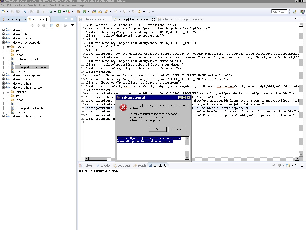

i am beginner with scount and start using Scout by following the HelloWorld tutorial. Everything works fine until i tried to run "dev server.launch" and "dev ui.launch". Error occured in Eclipse with following message
Launch configuration [webapp] dev server references non-existing project helloworld.server.app.dev.
i did nothing else except following the tutorial. Before launching the server, i have build all the HellowWorld projects with "maven install". Did anyone have the same problem? Can someone help me here? Thanks in advance.

When you start from Eclipse, no maven build is requested. It should just work.
From your screenshot I see the "helloworld.server.app.dev" project, so I can not explain why Eclipse says it is "non-existing"

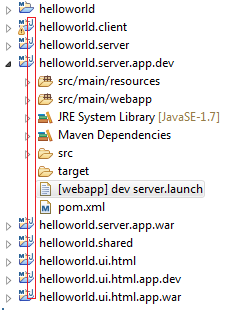

I have a really similar setup and it works on my machine.
In your screenshot, I have noticed that the java nature is missing on your projects:
index.php/fa/28403/0/
Maybe you select them in the Package Explorer and press ALT+F5 to run the "Update Maven Project" function.
The "src" Folder should have an "source" icon.
