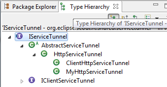

Re: [neon] How to pass per-request information from client to server? [message #1753625 is a reply to message #1753608] Wed, 08 February 2017 04:36 Go to previous messageGo to next message
The error is clear:
Assertion error: multiple instances found for query:
interface org.eclipse.scout.rt.shared.servicetunnel.IServiceTunnel
You can have a look at the Type Hierarchy of IServiceTunnel:
index.php/fa/28375/0/
You have a conlict because the Bean manager can not decide between:
* MyHttpServiceTunnel
* ClientHttpServiceTunnel
Using @Order as described by Arthur is one solution.
My guess is you want to @Replace ClientHttpServiceTunnel instead of HttpServiceTunnel
@Replace
public class MyHttpServiceTunnel extends ClientHttpServiceTunnel {
If you do it like this, the query for IServiceTunnel will provide an unambiguous result (your class).
