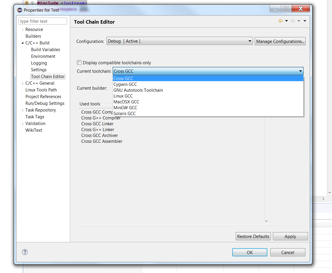

Problem Description:
Microsoft Visual C++ toolchain does not exist under Project \ Properties \ C/C++ Build \ Tool Chain Editor
index.php/fa/28182/0/Hello
My setup:
Windows 7
Eclipse Neon.2 / Eclipse Neon.1 (Same problem on both)
Microsoft Visual Studio Pro 2013
From Eclipse help I understand that this should work automatically
http://help.eclipse.org/neon/index.jsp?topic=%2Forg.eclipse.cdt.doc.user%2Fconcepts%2Fcdt_c_before_you_begin.htm
I also remember that in previous version, Microsoft Visual C++ used to appear on the list (even if not installed).
Does anyone run into the same problem and can help?

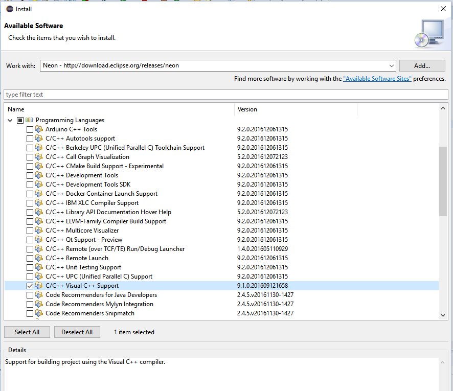

I assume you used the "Eclipse IDE for C/C++ Developers" package before. It doesn't include the "Visual C++" toolchain by default anymore. You have to install it as an optional feature. It's also not very maintained anymore.
Re: Microsoft Visual C++ toolchain does not exist [message #1752425 is a reply to message #1752423] Mon, 23 January 2017 11:26 Go to previous messageGo to next message
index.php/fa/28187/0/
  • Attachment: vcsupport.PNG
    (Size: 60.01KB, Downloaded 13951 times)
Re: Microsoft Visual C++ toolchain does not exist [message #1752527 is a reply to message #1752425] Tue, 24 January 2017 13:20 Go to previous messageGo to next message
Thanks, it does show me now the Visual C++ toolchain Smile
