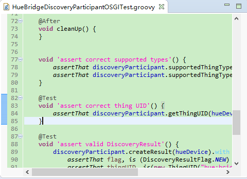

Re: Get A lot of ERROR while setup my ESH environment (T_T) [message #1752006 is a reply to message #1752001] Tue, 17 January 2017 11:28 Go to previous messageGo to next message
As I do as top , i then change the Groovy Compiler from 2.4 to 2.3 , restart the eclipse and now i get a problem of hue:
General error during class generation: nyi class
org.eclipse.jdt.internal.compiler.lookup.UnresolvedReferenceBinding
java.lang.IllegalStateException: nyi class org.eclipse.jdt.internal.compiler.lookup.UnresolvedReferenceBinding

Re: Get A lot of ERROR while setup my ESH environment (T_T) [message #1752216 is a reply to message #1752007] Thu, 19 January 2017 22:02 Go to previous messageGo to next message
I switch to Eclipse Neon now , trying to figure out what happened to me .According to http://groovy-eclipse-plugin.42567.n3.nabble.com/General-error-during-semantic-analysis-nyi-class-td4025328.html
and try to delete some tags in the file ,I simply remove @Test tag from 76 line and the error fly ,now it's clean and fine! But , why? Is there anybody could help me to figure this out?
After i choose to clean the project , rebuild it ,the error come to me AGAIN! I believe it doesn't work. Still waitting for someone to help me .
[Updated on: Thu, 19 January 2017 22:12] by Moderator
Re: Get A lot of ERROR while setup my ESH environment (T_T) [message #1752480 is a reply to message #1752216] Tue, 24 January 2017 06:01 Go to previous message
I have exactly the same error, also looking for a solution.
Behavior is the same: as soon as I remove some annotation (@Test or @After) in the file, the project gets automatically rebuilt and error is gone. But when cleaning the project and rebuilding the error comes back. It's not too bad since it does not hold one from coding but still.
