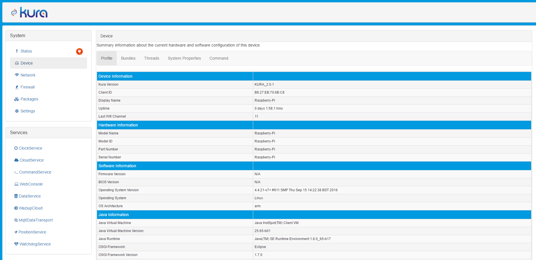

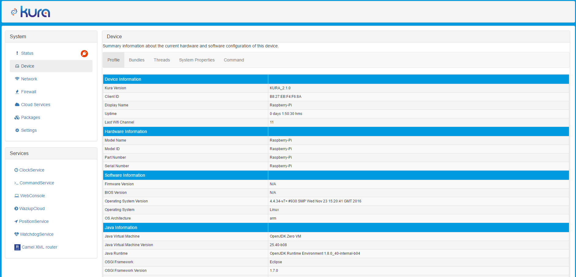

Well appareantly when I installed a new version of my bundle, the pannel is displayed (waziupCloud), although it is not working properly, the initial values is not taken into consideration and when I try to update it stays blocked on loading...and it does not update the values...
The web UI are attached:
*old web UI: (the one that is not working)
*New web UI (the working one)
oh it is not the same versions at all! I was confused about 2.0.1 and 2.1.0!

From what I see, one raspberry uses kura 2.0.1, the other Kura 2.1.0.
Apart from bugs I'm not aware of, the two installations should behave in the same way.
