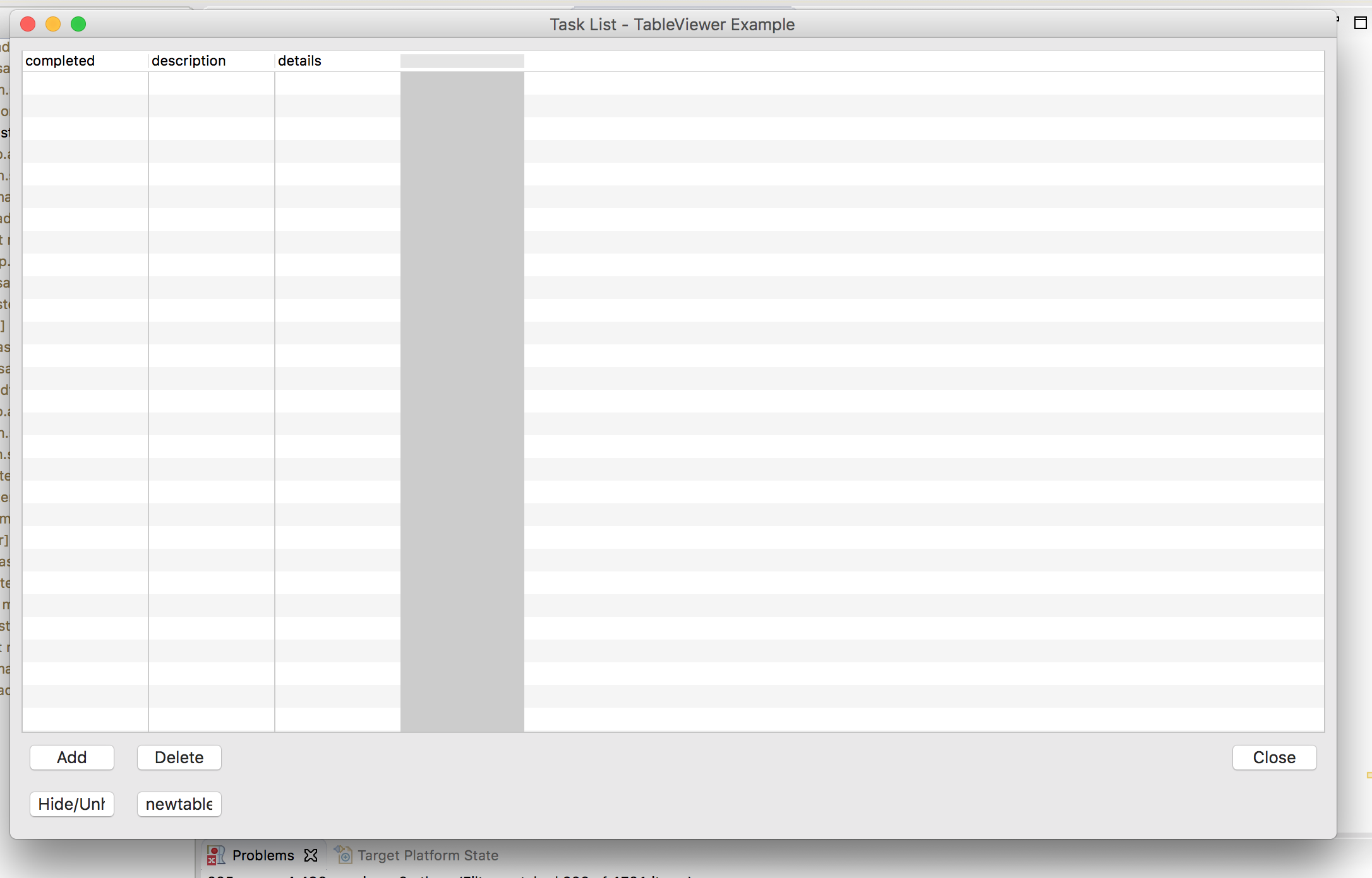

I have a tableviewer for which a table contains 100 columns.
I would like to hide columns as per my requirement.
In one scenario,I would like to see only 1 column ,in an other scenario i would like to see 50 columns .etc.
There is data persisted on each column.
I also have multiple tables but i show only 1 table at a time based on the user selection of the table.
Issue:
To hide the unwanted columns to be shown I am using
column.setWidth(0) for a tablecolumn.
In case of Windows the tablecolumns are getting shown properly but in case of Macintosh OS ,there is a thick line which gets appended at the end after hiding the columns.
The length of this thick blurred line is propotional to the number of columns i hide ..i.e. by setting columns.setWidth(0).
PFA screen shot.
Is there a way where I can eliminate showing of the thick line in MAC?
Am I missing to call any method which is what is causing the issue?
It would be great if someone helps me with this issue.
