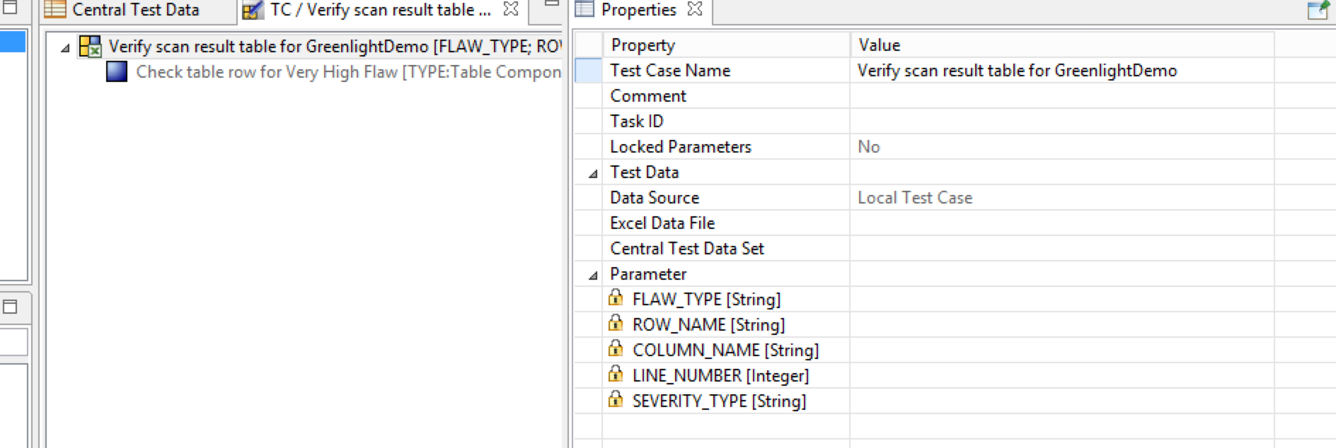

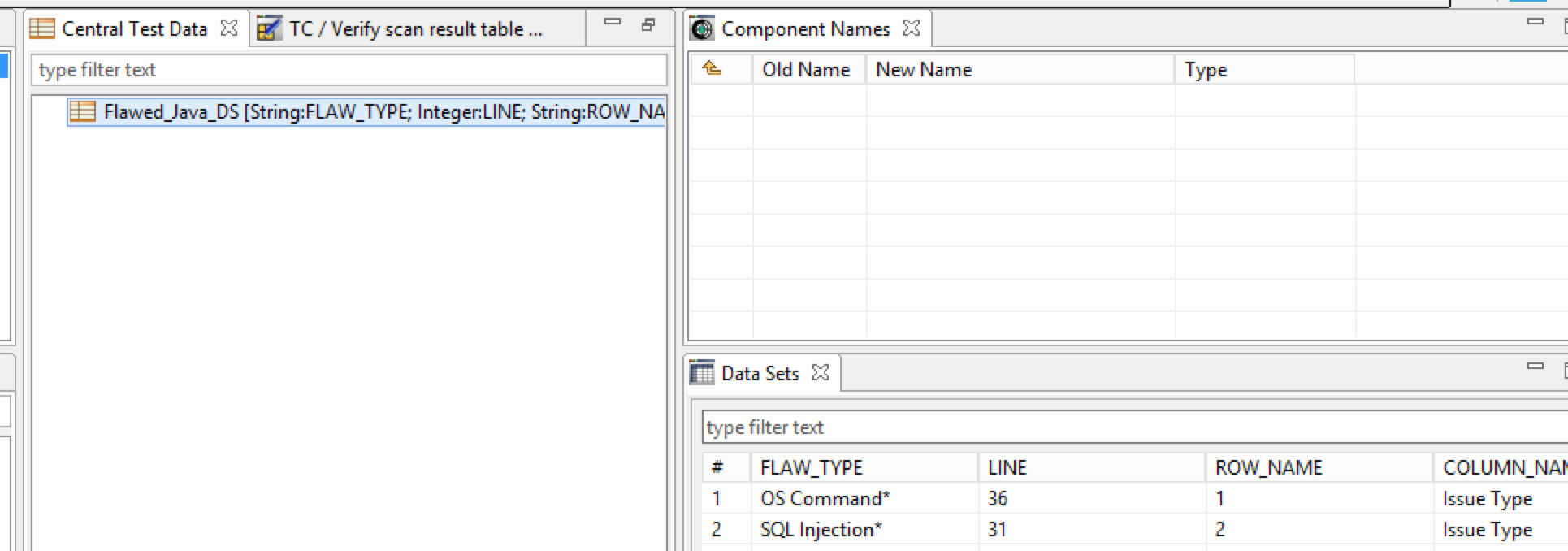

I am using Jubula8.3.1 to test Eclipse Plugin.
A Central Test Data has my test data set.
index.php/fa/27633/0/
But there is no way to switch the data source to Central Test Data Set
index.php/fa/27634/0/

Hi Khanh,
the names ot the parameters must fit. From your example I can see that you use the name "LINE" in the central test data set, and LINE_NUMBER in the Test Case.
If you make sure that the names match up, then you should be able to select it.

Thanks, after I fixed my data column and row names, the test data from central data work as expected.
Sorry for the confusion.
