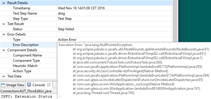

the error occures sometimes when i am executing my javafx test with drag and drop on shapes (Jubula Version: 8.3.1.125).
sometimes the test seems to be successful, because no error occurs, but the drag and drop in the AUT was not succesful. i am not sure why the error does not occur sometimes.
when i click in "Test Result" on the child were the Action Error occures then the following is shown in "Properties" tab in Error Details/Error Description:
Execution Error: "java.lang.NullPointerException
at org.eclipse.jubula.rc.javafx.util.NodeBounds.getAbsoluteBounds(NodeBounds.java:81)
at org.eclipse.jubula.rc.javafx.driver.RobotJavaFXImpl$2.call(RobotJavaFXImpl.java:651)
at org.eclipse.jubula.rc.javafx.driver.RobotJavaFXImpl$2.call(RobotJavaFXImpl.java:1)
at java.util.concurrent.FutureTask.run(FutureTask.java:266)
at com.sun.javafx.application.PlatformImpl.lambda$null$173(PlatformImpl.java:295)
at com.sun.javafx.application.PlatformImpl.lambda$runLater$174(PlatformImpl.java:294)
at com.sun.glass.ui.InvokeLaterDispatcher$Future.run(InvokeLaterDispatcher.java:95)
at com.sun.glass.ui.win.WinApplication._runLoop(Native Method)
at com.sun.glass.ui.win.WinApplication.lambda$null$148(WinApplication.java:191)
at java.lang.Thread.run(Thread.java:745)

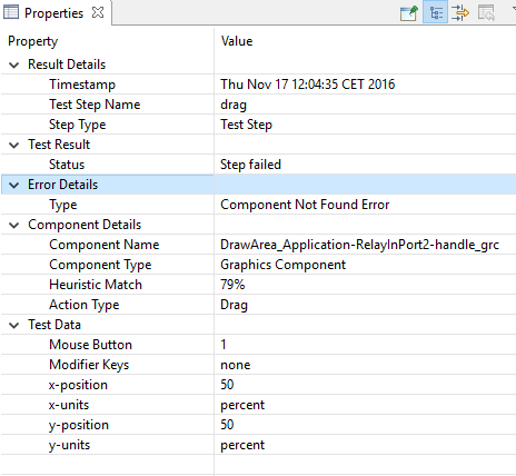

i executed the test again and this time i get an "Component Not Found Error" for the component of the same test step.

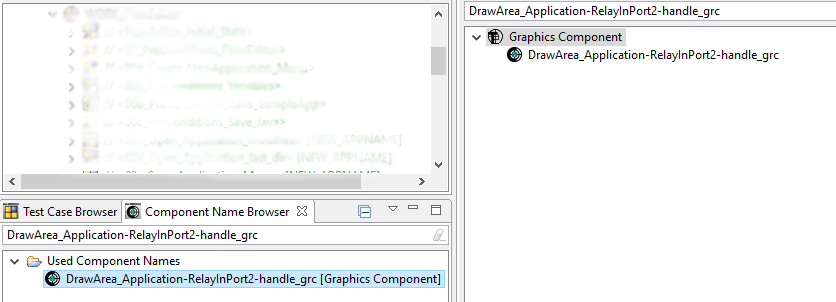

when i search for that component name in Component Name Browser or Object Mapping Editor it is there and "Highlight in AUT" is functioning also.

as you can see on the second screenshot the heuristic match is 79%. is that pretty low?
a problem could be that for that component i have a second component that is very similar. it has the same context (parent and sisters), only name and position are different.
Re: Execution Error: "java.lang.NullPointerException [message #1748225 is a reply to message #1748219] Mon, 21 November 2016 06:42 Go to previous message
Yes and Yes. However, we mainly use the name for the heuristic lookup and if the name for the component is unique we should reliably find that component. Could you check if that is the case? Or if the name of the component was generated by jubula, i.e. "ComponentType"_1,2.... In that case please check if providing a unique name for that component fixes the problem.
