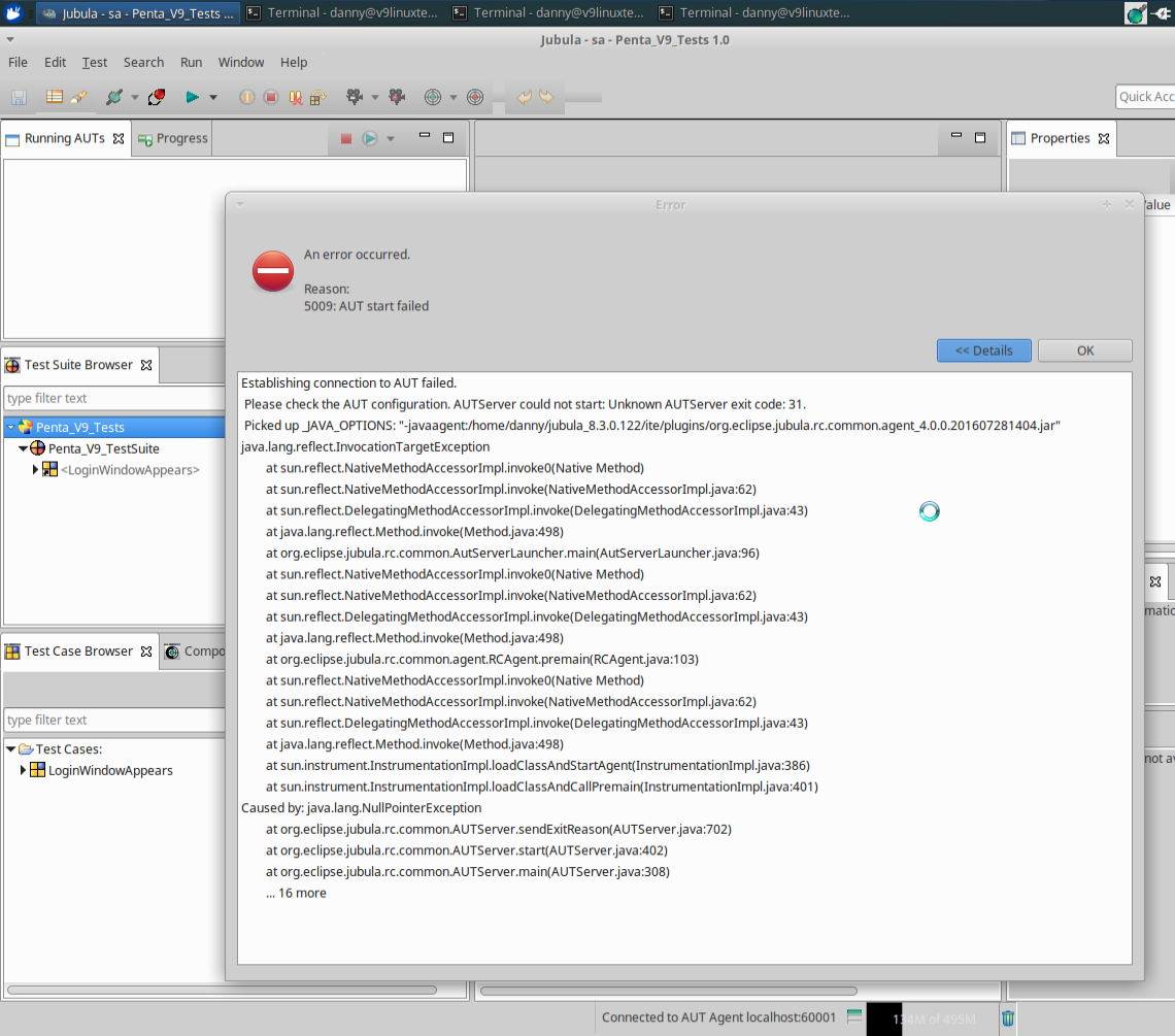

Re: testexec on Linux: NullpointerExecption while starting AUT [message #1744411 is a reply to message #1743293] Mon, 26 September 2016 11:54 Go to previous message
Alexandra Schladebeck wrote on Wed, 14 September 2016 02:51
Hi there,
thanks for the information. If you start the ITE on that system and try to start the AUT via the ITE, do you get the same error?
Alex
Hi Alex,
Yes, I see the same error in the eclipse environment on linux. As I said before I think, the NullPointerException should be avoided in the code.
