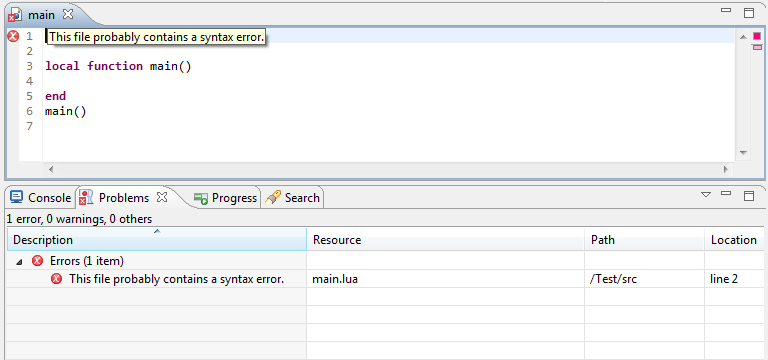

Empty project - "This file probably contains a syntax error" [message #1736910] Mon, 04 July 2016 06:50 Go to next message
Last (1.3.1) LDT version
Win 7 x64
The problem:
index.php/fa/26367/0/
Can you help me?
  • Attachment: error.png
    (Size: 18.83KB, Downloaded 919 times)
Re: Empty project - "This file probably contains a syntax error" [message #1737195 is a reply to message #1736910] Wed, 06 July 2016 06:29 Go to previous messageGo to next message
I tried this in my win7x64 VM and it works for me.
Maybe you should check that you are running a 64 bit version of LDT with a Java 8 64 bit.
Re: Empty project - "This file probably contains a syntax error" [message #1760356 is a reply to message #1737195] Wed, 26 April 2017 05:17 Go to previous message
At the moment I do not have time to deal with this. I'll deal with it later.
Exception сall stack:
com.naef.jnlua.LuaRuntimeException: ...pse.ldt.metalua\lib\metalua\compiler\parser\meta.lua:41: attempt to call local 'f' (a nil value)
at com.naef.jnlua.LuaState.lua_pcall(Native Method)
at com.naef.jnlua.LuaState.call(LuaState.java:555)
[Updated on: Wed, 26 April 2017 05:18] by Moderator
