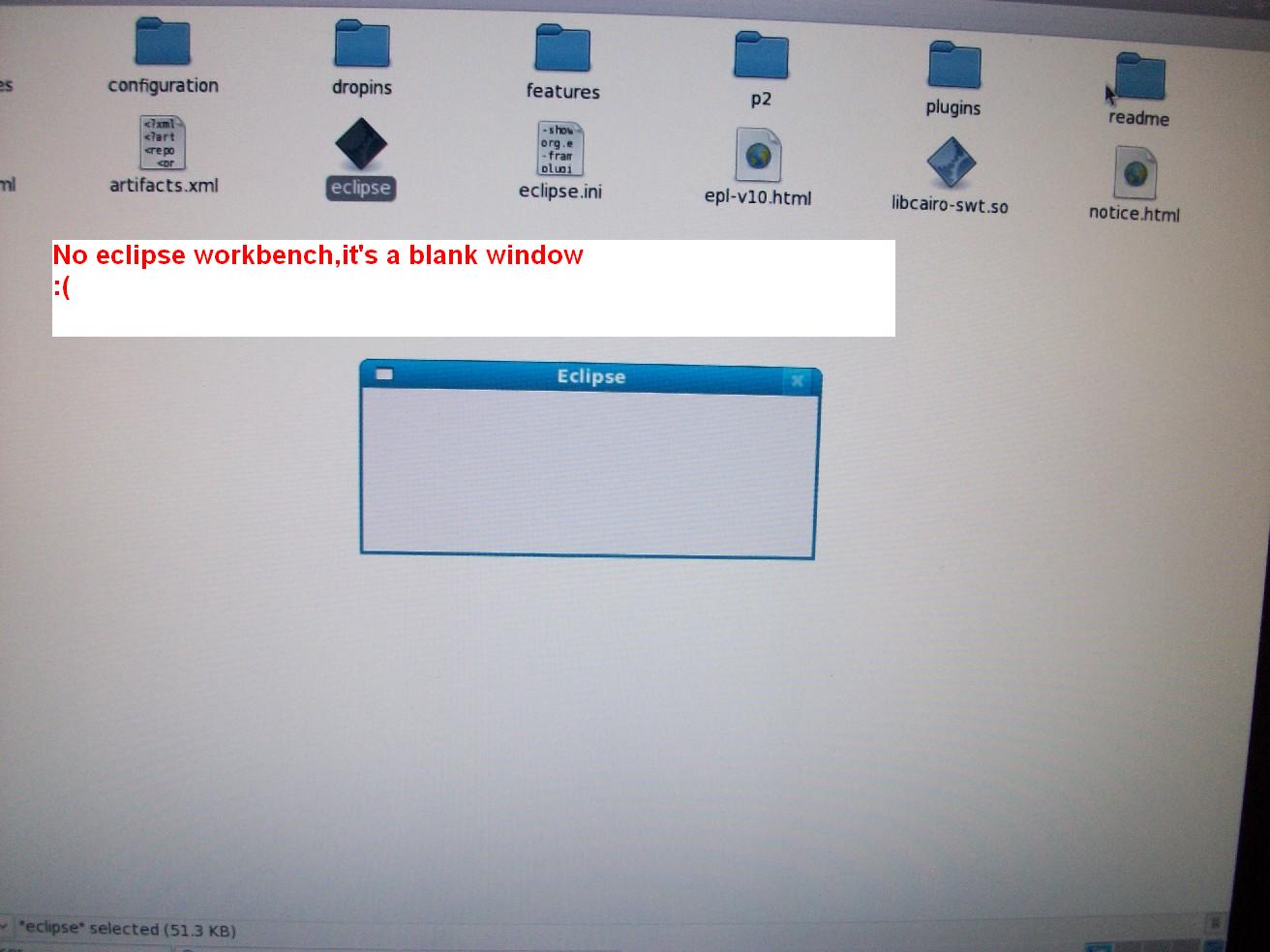

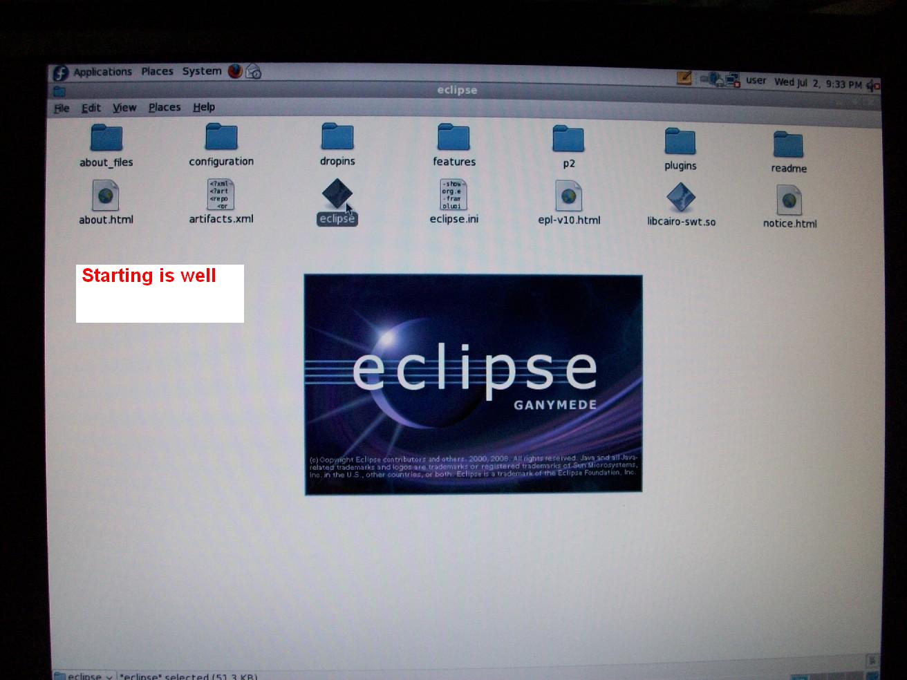

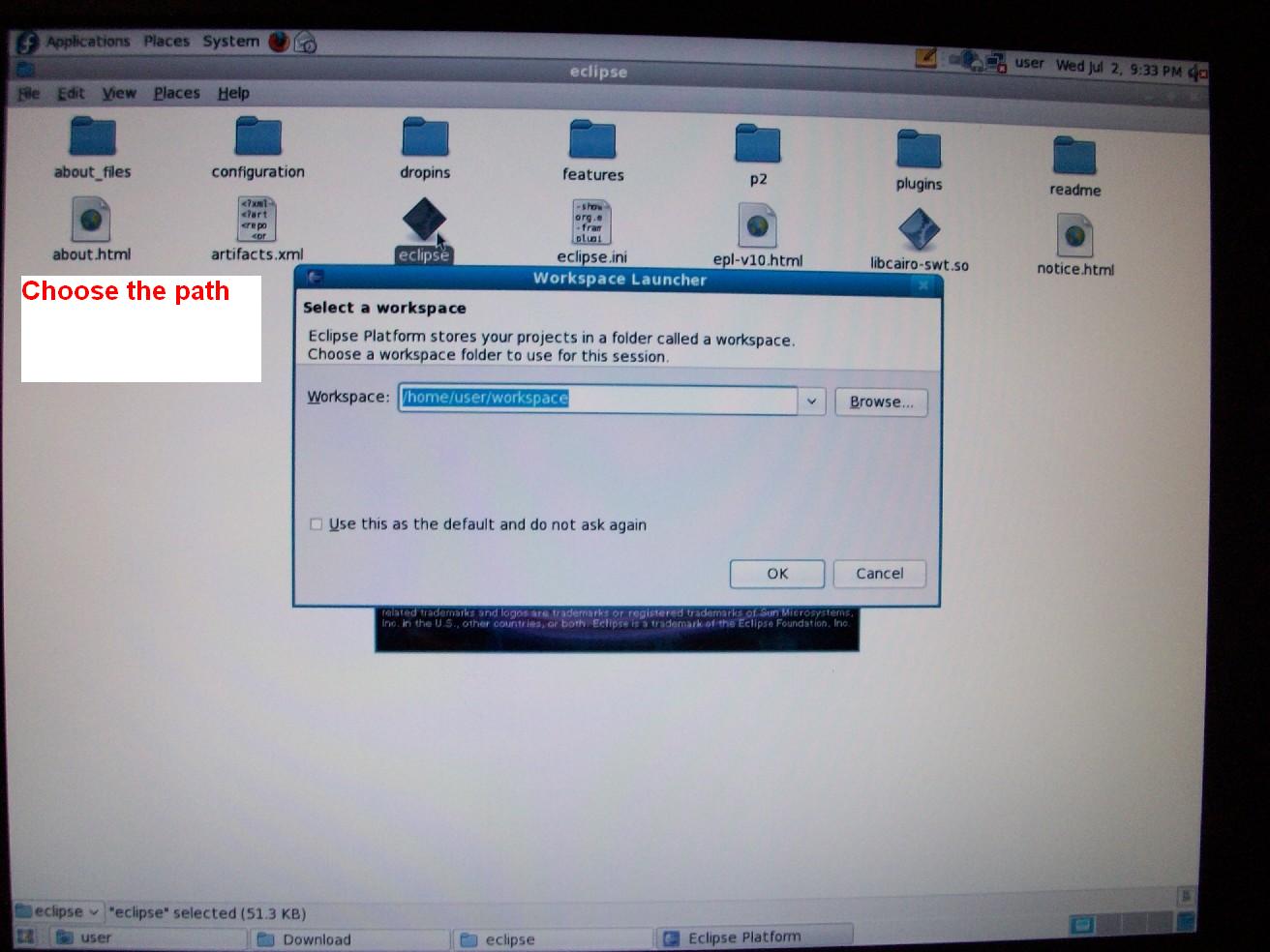

Today I download eclipse3.4 and I want to run it on Fedora9.It goes well
during the starting , but after I select a path for workspace ,the eclipse
doesn't display the workbench instead of a blank window(please see the
pictures)
I don't know why,so I run the eclipse3.3,it can go.

It sounds like https://bugs.eclipse.org/bugs/show_bug.cgi?id=239209
Can you get any further if you start eclipse with:
eclipse -data tmp_ws
That should create the tmp_ws where you can find the .metadata/.log file
PW

I suppose that you have a problem with Firefox 3.
You can try the following:
- remove Firefox 3 or install a newer version
- add the VM argument -Dorg.eclipse.swt.browser.XULRunnerPath=/dev/null
when starting eclipse
You can also take a look at this comment:
https://bugs.eclipse.org/bugs/show_bug.cgi?id=235020#c2
