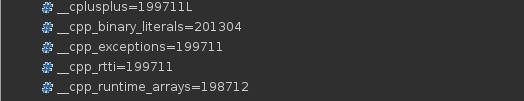

I don't use managed builds at all. It's not clear what gcc does with -c++11 flag but apparently it turns on some preprocessor macros starting with __cpp. These are likely what the indexer needs . I't hard to get a complete list of these. The following are set in the CDT GCC Builtin Compiler Settings in my projects although 1997 and 1987 dates suggest they aren't related to C++11.
index.php/fa/23447/0/
