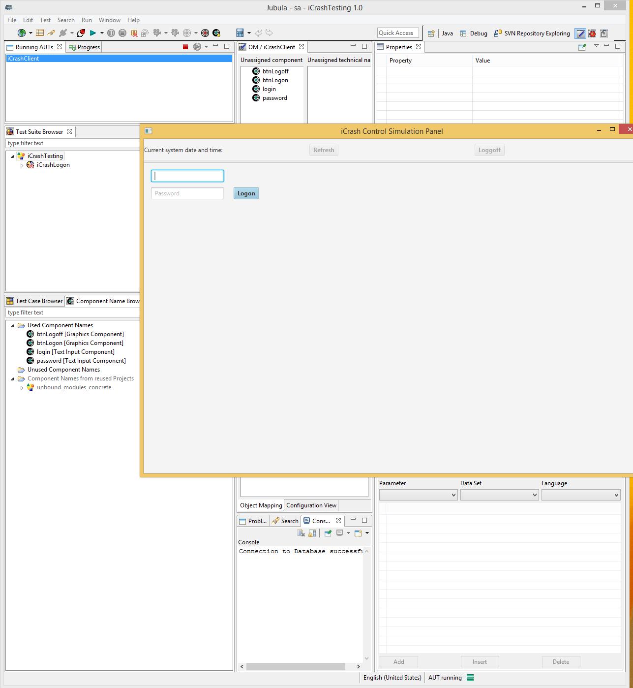

Yes it is started, I've attached a screenshot and a Zip file with the application and batch file I'm using to run it. You can run it without the server, it will just error saying it can't reach it and show the login screen. I'm attempting to map the textfield, passwordfield and the button on the login pane shown. I'm downloading the sprint increment now and will be able to test that shortly.
Thanks for the help!
