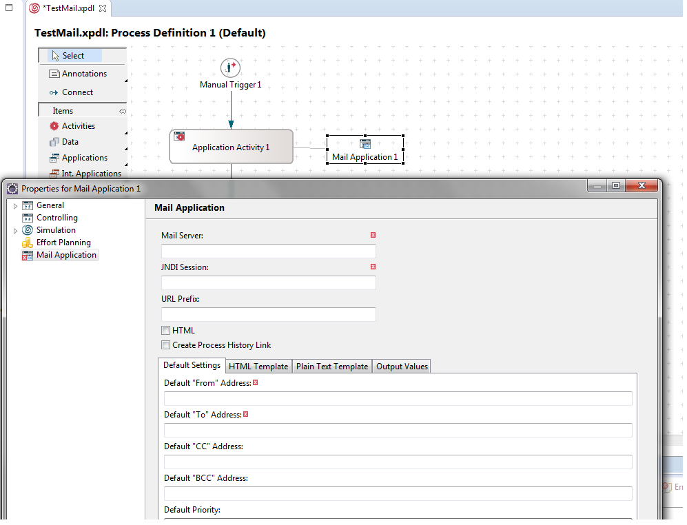

Is it possible to use a Gmail account to test and send mails from a process activity ? (It has something like JNDI session!)
index.php/fa/22596/0/
If yes, would it be possible for you to share with me some link or document for the same.
Kunal.
