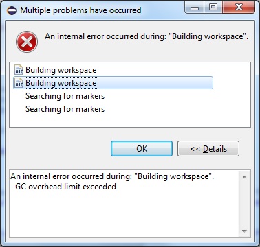

I added my joomla project to a workspace with Java script validation(or something like this may be javascript support), When I'm traing to Run my web aplication or trying to save edited php file Building workspace window arise. Then program thinks a great period of time and hanging while investigating the "js" subfolder of my joomla template folder. Then this error window finaly appears:
index.php/fa/21828/0/
After closing this windows Eclipse suggest me to cloce workbench at all.

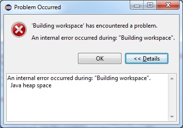

The second try to save my php file arised me another error window:index.php/fa/21829/0/
Please help me to make my joomla project work fine and quickly without this error

Hello.
I've tried to run my Joomla project again, but i recieved "GC overhead limit exceeded" message agein. Here is my log file
