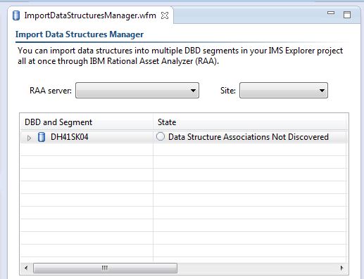

I am trying to access the tree within the CTab
index.php/fa/21057/0/
If anyone knows a way to get an instance of that tree so I can expand the nodes and access the items inside, would be greatly appreciated.
Most of the methods below works for tabs that are easy to access with a single tree such as the picture below, however they are unable to detect the tree when it is embedded inside
Currently these are the things I have tried, each giving a Widget Not Found Invocation Error.

Re: How to Access a Tree inside a CTab? [message #1683746 is a reply to message #1648440] Wed, 18 March 2015 02:29 Go to previous messageGo to next message
I have the same problem, and I use below code try to retrieve all controller under current shell, there is no table or tree.
ControlFinder controlFinder = new ControlFinder();
java.util.List<Widget> findControls = controlFinder.findControls(withRegex(".*"));
Re: How to Access a Tree inside a CTab? [message #1717350 is a reply to message #1683746] Fri, 11 December 2015 18:43 Go to previous messageGo to next message
Why don't you try using the eclipse spy view to ensure whether the element is tree or not?
Re: How to Access a Tree inside a CTab? [message #1717351 is a reply to message #1717350] Fri, 11 December 2015 18:48 Go to previous message
Try this..
SWTBot editorBot = bot.editorByTitle("ImportDataStructuresManager.wfm").bot();
SWTBotTreeItem DHNode= editorBot.tree().getAllItems()[0];
