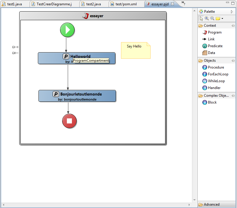

Thank you very much for your reponse. I have tried as the document says. But I couldn't find the actions for the GEF composites.
And for the example for adding accessibility in the reference, when I import in eclipse as it says, there is a mistake
"Cannot nest 'D:Utilisateurs/A534346/Desktop/eclipse-jee-indigo-SR2-win32-x86_64/eclipse/plugins/org.eclipse.jubula.rc.rcp_1.1.0.201109140653/resources' inside library 'D:Utilisateurs/A534346/Desktop/eclipse-jee-indigo-SR2-win32-x86_64/eclipse/plugins/org.eclipse.jubula.rc.rcp_1.1.0.201109140653'".
I have tried to change the plugin "org.eclipse.jubula.rc.rcp", but I didn't succeed. Can you help with the two problems? Thank you very much.

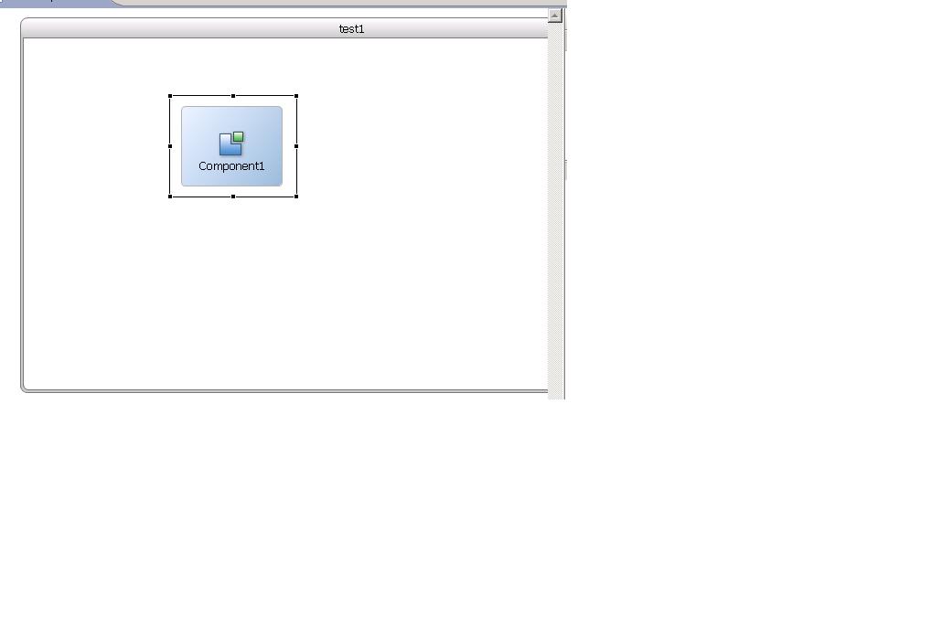

Hi, I am also trying to test my RCP application which has a GEF editor in it. I have followed the steps Marzia has given. I am able to capture the textpath for the canvas and GEF components. When I use click in figure step to click into canvas, it clicks the canvas but it does not able to click the component inside canvas.
Could you tell me what steps have you used for this? I have attached screen shot of the canvas for your reference.

Re: test for GEF with Jubula [message #998112 is a reply to message #997979] Wed, 09 January 2013 06:50 Go to previous messageGo to next message
Hi, try to use ub_fcv_clickFigure_byTextPath
This keyword selects component on a canvas
Alex
