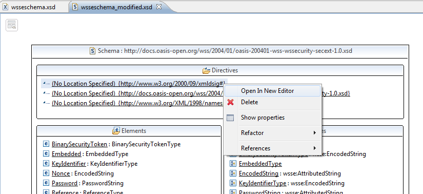

I have a schema that contains the import statement <import namespace="h t t p://www.w3.org/2000/09/xmldsig"/>. I am trying to load such schema, as well as all other schemas that this schema imports (sorry I have to put spaces in the namespace because it does not let me put a link unless I have posted more than 5 messages). The actual schema is attached in this message.
Two issues happen when my code encounters the import for h t t p://www.w3.org/2000/09/xmldsig:
1. It takes a long time to execute the line XSDImportImpl.importSchema() as shown below.
2. Finally importSchema() returns an importedSchema with null targetNamespace.
XSDImport imported = (XSDImport)schemaContent;
String location = imported.getSchemaLocation();
XSDSchema importedSchema = ((XSDImportImpl)imported).importSchema();
I open another schema that contains the same import in Eclipse's XSD editor. When I right click on the import to open it in a new editor, Eclipse seems to hang forever.
index.php/fa/6004/0/
Is this as expected or I am doing something that I'm not supposed to do?

If I enter this URI in the browser, it hangs for a long time too and it
never does seem to return a schema. It would be better to specify a
schema location for this. One where a schema can be quickly found.
