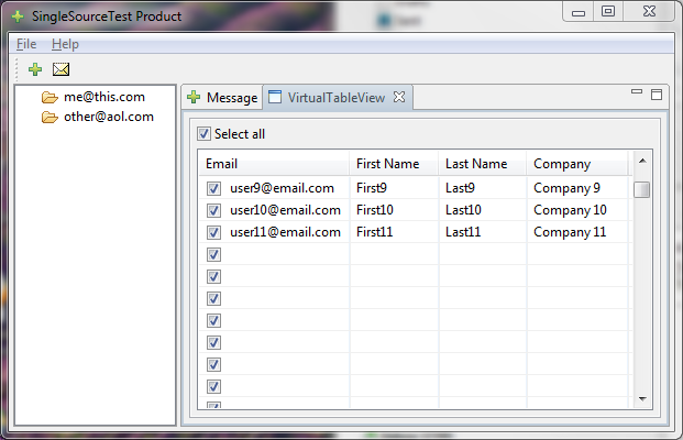

Re: Virtual table and select all items problem still valid [message #701656 is a reply to message #699905] Mon, 25 July 2011 07:36 Go to previous messageGo to next message
Hi Ivan,
Thank you for the info.
Interesting, I reproduced different behavior:
In single-sourced project I added CheckBoxTableViewer in a view with
data- and label- providers and 150 entries.
The result in RAP is consistent (the bug discussed) but in RCP different
thing happens (find the attached screen shot):
All table rows are checked but the rows are not updated with contents on
scroll down.
So what do we do with this problem?
- I send the single sourced demo project to see if I abuse the API somehow;
- I write a 'select all' button in the RAP Controls demo in order to
reproduce and verify the bug;
- We ask RPC to fix that bug;
- We fix the bug and propose solution to RCP;
I am out of ideas.
I will be glad to help you out with this issue,
Aleks

> On 22.7.2011 г. 17:43 ч., Ivan Furnadjiev wrote:
>> Hi Aleks,
>> just checked in RCP and the behavior is the same with RAP - on
>> CheckboxTableViewer#setAllChecked( true ) only visible items are checked.
>> The code:
>> public void setAllChecked(boolean state) {
>> TableItem[] children = getTable().getItems();
>> for (int i = 0; i< children.length; i++) {
>> TableItem item = children[i];
>> if (item.getData() != null) {
>> if (item.getChecked() != state)
>> item.setChecked(state);
>> set the checked state only for the items that item.getData() is not
>> null. Virtual (hidden) items have null data.
>> HTH,
>> Ivan

Hi Ivan,
Sure, I attach zip archive with the single-sourced demo.
I have no progress modifying the RAP demo, as it does not use
CheckboxTableViewer.
Hope that helps,
Aleks
