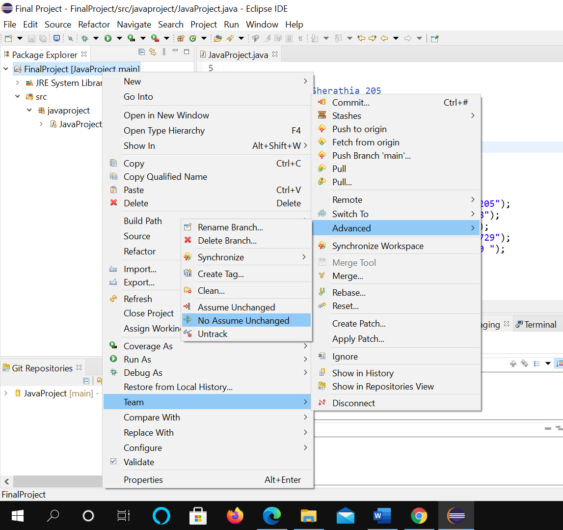

Re: assume unchanged [message #1835511 is a reply to message #576997] Sat, 05 December 2020 06:58 Go to previous messageGo to next message
So this happened!
I accidently clicked on "assume unchanged"!
I tried searching on internet, but could not find any working solution!
So, I tried few things here and there and finally I found the solution for this which will undo the assume unchanged!
Right click on "Your Project" then Team>Advanced>No assume Unchanged
That's it!
(Check the image below)
Re: assume unchanged [message #1835520 is a reply to message #1835511] Sat, 05 December 2020 11:39 Go to previous message
Well yes, that's what Matthias wrote in January 2020. (One minor difficulty is: if you click "Assume unchanged" in the staging view, the file will disappear there. You have to find it again in the package/project explorer and execute "No assume unchanged" there.)
