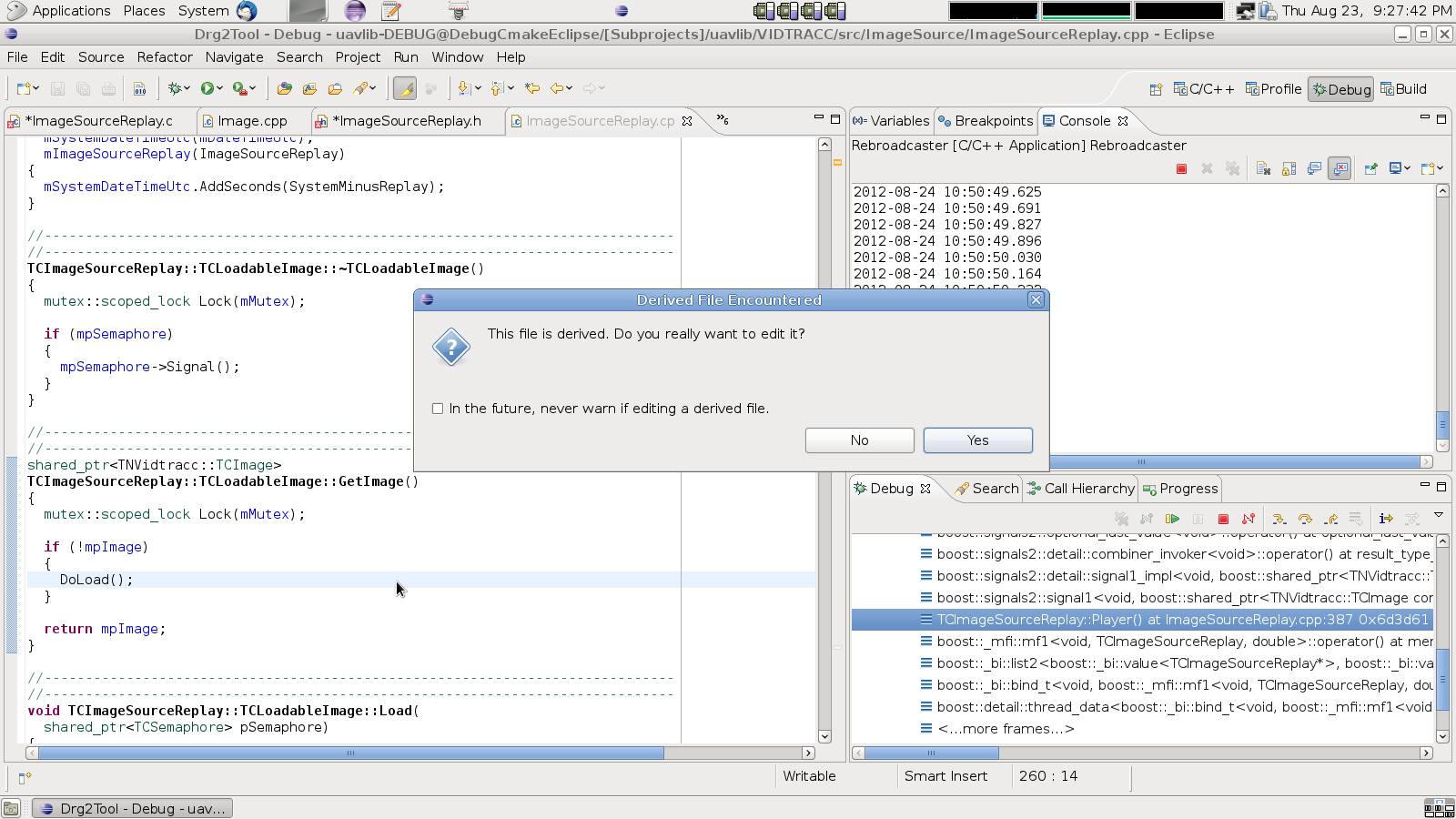

Thank you for this tip. I have been using it for the past couple weeks. I like that I can mark a project "derived" and signal that it should not be used for source code editing. I do not use Eclipse's 'search' feature, but I do believe you when you say "derived" projects are excluded from search results.
An eclipse feature that I use (and love) is F3 also known as "Open Declaration". Sometimes (I'd say 20% of the time) using F3 brings me to source code in a "derived" project. I generally do not notice when this happens. However, if I attempt to edit the source code, Eclipse CDT interrupts me with a modal dialog: 'Are you sure you want to edit source code in a "derived" project?'
Question: Can I command Eclipse/CDT to never direct me to "derived" projects when performing an F3/Open_Declaration?
Thank you again for your help,
Chris
