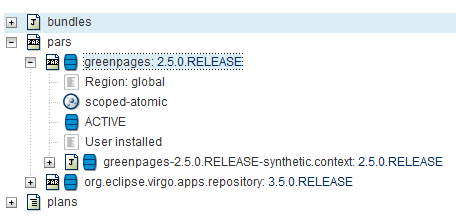

This is what I see from Admin Console
index.php/fa/11758/0/

When I tried following the instructions in the Greenpages 2.5.0 documentation to get Greenpages running under Eclipse, I observed two problems. The first one was that the PAR file did not deploy successfully since the synthetic context bundle seemed to have an import for org.h2.driver which could not be resolved (from the bundles in the PAR). This is weird, since none of the bundles in the PAR export org.h2.driver and so the synthetic context bundle shouldn't need to import it. But that's clearly not the problem above as deployment seems to have been successful there.
But what I also observed was that even though I could create a PAR project containing all four greenpages bundles, the resultant PAR (in the stage directory of VTS) was missing the greenpages.web bundle, which would certainly explain why the browser couldn't find the relevant address.
