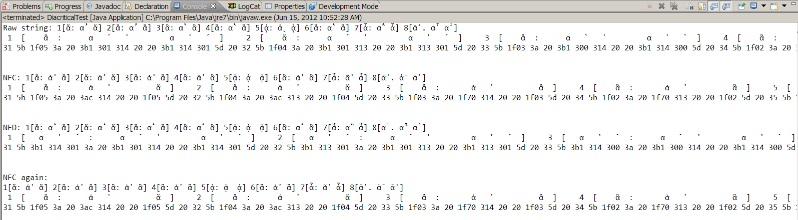

Output of combining characters [message #886756 is a reply to message #885155] Fri, 15 June 2012 11:23 Go to previous messageGo to next message
Thanks, Dani, for your reply. I appreciate it and look forward to the new version of Eclipse.
I hope this isn't too off-topic for this thread, but I've just noticed another couple issues with Unicode and the Eclipse console--has to do with display of "combining characters" (and Unicode normalization).
In this discussion, it's good to keep in mind the Unicode standard as described here: unicode.org/reports/tr15/. For ease of reference, here is Java 7's Normalizer class doc docs.oracle.com/javase/7/docs/api/java/text/Normalizer.html. (I still can't post links.)
Below I've pasted some code that shows the trouble, along with its output. (Again, I'm using polytonic Greek.) The first glyph in each grouping (before the colon) is how the following two should look. You can see how putting the breathing mark first after the letter makes the second glyph turn out properly, whereas putting the accent first makes it turn out wrong. (The macron case is special, because there are no single glyphs with macrons and accents/breathing marks.)
It appears to me that there are two closely related issues.
The first issue is that Java's Normalizer.normalize method doesn't follow the Unicode standard in displaying combining diacritics in whatever order as the same unitary glyph (as is evident from the codepoints beneath).
That process logically starts at the front of the string and systematically checks it for pairs of characters which meet certain criteria and for which there is a canonically equivalent composite character in the standard. Each appropriate pair of characters which meet the criteria is replaced by the composite character, until the string contains no further such pairs. This transforms the fully decomposed string into its most fully composed but still canonically equivalent sequence.
Failing to do that is no small breach! I'm reporting the bug to the Java folks.
The second issue is that Eclipse shows some orderings of combining characters as if they were part of the next character, and not part of the preceding character (as they should be). This happens in the editor and not only in the console. This would appear to be a problem with the way Eclipse displays and not with Java itself (though Java's problem might be implicated)-- at very least the messy diacriticals should appear over the proper glyph.
Actually, it might be impossible to disentangle the two issues for Eclipse. Nevertheless I would guess there is a workaround, as far as display is concerned, that would bypass Java's deficiencies. I could be wrong though.
What do you think?

Here's the output, first as text, then as a graphic, in case the former doesn't work:
Raw string: 1[ἅ: ά̔  ἅ] 2[ἄ: ά̓  ἄ] 3[ἃ: ὰ̔  ἃ] 4[ἂ: ὰ̓  ἂ] 5[ᾁ: ᾁ  ᾁ] 6[ἂ: ὰ̓  ἂ] 7[ἇ: ᾶ̔  ἇ] 8[ᾱ̔ . ἁ̄  ᾱ̔ ]
 1  [    ἅ  :      α   ́    ̔          α   ̔    ́   ]     2  [    ἄ  :      α   ́    ̓          α   ̓    ́   ]     3  [    ἃ  :      α   ̀    ̔          α   ̔    ̀   ]     4  [    ἂ  :      α   ̀    ̓          α   ̓    ̀   ]     5  [    ᾁ  :      α   ͅ    ̔          α   ̔    ͅ   ]     6  [    ἂ  :      α   ̀    ̓          α   ̓    ̀   ]     7  [    ἇ  :      α   ͂    ̔          α   ̔    ͂   ]     8  [    ᾱ   ̔      .      α   ̔    ̄          α   ̄    ̔      ]
31 5b 1f05 3a 20 3b1 301 314 20 20 3b1 314 301 5d 20 32 5b 1f04 3a 20 3b1 301 313 20 20 3b1 313 301 5d 20 33 5b 1f03 3a 20 3b1 300 314 20 20 3b1 314 300 5d 20 34 5b 1f02 3a 20 3b1 300 313 20 20 3b1 313 300 5d 20 35 5b 1f81 3a 20 3b1 345 314 20 20 3b1 314 345 5d 20 36 5b 1f02 3a 20 3b1 300 313 20 20 3b1 313 300 5d 20 37 5b 1f07 3a 20 3b1 342 314 20 20 3b1 314 342 5d 20 38 5b 1fb1 314 20 2e 20 3b1 314 304 20 20 3b1 304 314 20 5d
NFC: 1[ἅ: ά̔  ἅ] 2[ἄ: ά̓  ἄ] 3[ἃ: ὰ̔  ἃ] 4[ἂ: ὰ̓  ἂ] 5[ᾁ: ᾁ  ᾁ] 6[ἂ: ὰ̓  ἂ] 7[ἇ: ᾶ̔  ἇ] 8[ᾱ̔ . ἁ̄  ᾱ̔ ]
 1  [    ἅ  :      ά   ̔           ἅ  ]     2  [    ἄ  :      ά   ̓           ἄ  ]     3  [    ἃ  :       ὰ   ̔           ἃ  ]     4  [    ἂ  :       ὰ   ̓           ἂ  ]     5  [    ᾁ  :       ᾁ          ᾁ  ]     6  [    ἂ  :       ὰ   ̓           ἂ  ]     7  [    ἇ  :       ᾶ   ̔           ἇ  ]     8  [    ᾱ   ̔      .       ἁ   ̄           ᾱ   ̔      ]
31 5b 1f05 3a 20 3ac 314 20 20 1f05 5d 20 32 5b 1f04 3a 20 3ac 313 20 20 1f04 5d 20 33 5b 1f03 3a 20 1f70 314 20 20 1f03 5d 20 34 5b 1f02 3a 20 1f70 313 20 20 1f02 5d 20 35 5b 1f81 3a 20 1f81 20 20 1f81 5d 20 36 5b 1f02 3a 20 1f70 313 20 20 1f02 5d 20 37 5b 1f07 3a 20 1fb6 314 20 20 1f07 5d 20 38 5b 1fb1 314 20 2e 20 1f01 304 20 20 1fb1 314 20 5d
NFD: 1[ἅ: ά̔  ἅ] 2[ἄ: ά̓  ἄ] 3[ἃ: ὰ̔  ἃ] 4[ἂ: ὰ̓  ἂ] 5[ᾁ: ᾁ  ᾁ] 6[ἂ: ὰ̓  ἂ] 7[ἇ: ᾶ̔  ἇ] 8[ᾱ̔ . ἁ̄  ᾱ̔ ]
 1  [   α   ̔    ́   :      α   ́    ̔          α   ̔    ́   ]     2  [   α   ̓    ́   :      α   ́    ̓          α   ̓    ́   ]     3  [   α   ̔    ̀   :      α   ̀    ̔          α   ̔    ̀   ]     4  [   α   ̓    ̀   :      α   ̀    ̓          α   ̓    ̀   ]     5  [   α   ̔    ͅ   :      α   ̔    ͅ          α   ̔    ͅ   ]     6  [   α   ̓    ̀   :      α   ̀    ̓          α   ̓    ̀   ]     7  [   α   ̔    ͂   :      α   ͂    ̔          α   ̔    ͂   ]     8  [   α   ̄    ̔      .      α   ̔    ̄          α   ̄    ̔      ]
31 5b 3b1 314 301 3a 20 3b1 301 314 20 20 3b1 314 301 5d 20 32 5b 3b1 313 301 3a 20 3b1 301 313 20 20 3b1 313 301 5d 20 33 5b 3b1 314 300 3a 20 3b1 300 314 20 20 3b1 314 300 5d 20 34 5b 3b1 313 300 3a 20 3b1 300 313 20 20 3b1 313 300 5d 20 35 5b 3b1 314 345 3a 20 3b1 314 345 20 20 3b1 314 345 5d 20 36 5b 3b1 313 300 3a 20 3b1 300 313 20 20 3b1 313 300 5d 20 37 5b 3b1 314 342 3a 20 3b1 342 314 20 20 3b1 314 342 5d 20 38 5b 3b1 304 314 20 2e 20 3b1 314 304 20 20 3b1 304 314 20 5d
NFC again:

Re: Output of combining characters [message #887199 is a reply to message #886756] Sat, 16 June 2012 03:27 Go to previous message
Please file bug a bug report against Platform Debug and cc me.
Dani
