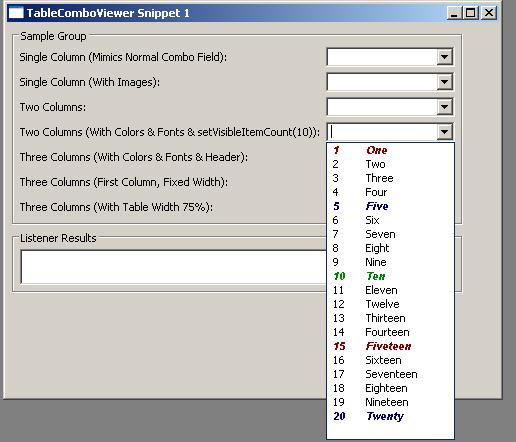

yes i did look at those samples, and if i look at TableComboViewer Snippet 1, at the two columns with colors, fonts part i see in code:
		// Sample #4
		// create label
		label = new Label(group, SWT.NONE);
		label.setText("Two Columns (With Colors && Fonts):");
		// create TableCombo
		tcv = new TableComboViewer(group, SWT.READ_ONLY | SWT.BORDER);
		tcv.getTableCombo().setLayoutData(new GridData(125, SWT.DEFAULT));
		tcv.getTableCombo().setVisibleItemCount(10);
what i see on screen is shown in my attachment (twenty entries - yes i edited the label)

Re: TableComboViewer Scrollbars? [message #1229425 is a reply to message #1229411] Thu, 09 January 2014 07:19 Go to previous messageGo to next message
RESOLVED!
i downloaded a build from 2014 and its fixed. (mine was 2011 version 1.0.0)
