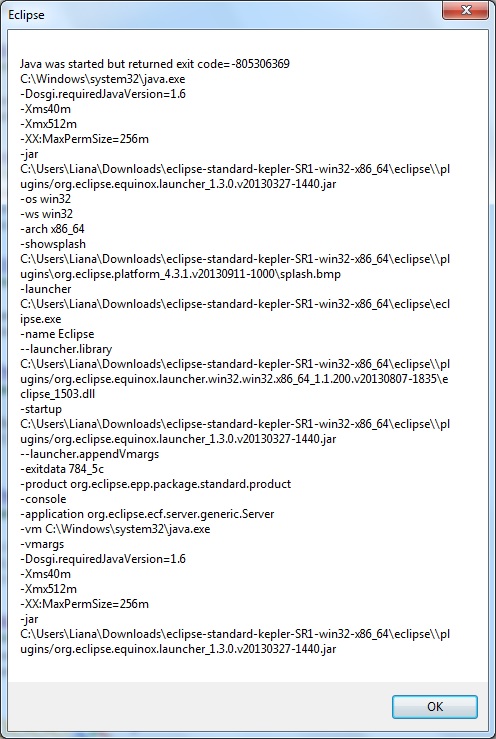

Thank you for replying.
I followed your instructions however when Eclipse started, it is not responding and pop out a message.
As attached is the screenshot of the message.
