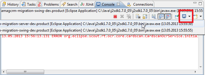

I'm not sure about the Derby problem. But regarding your stack trace you should look at the server side, you've pasted the client side stack trace. If you are running your application from within Eclipse you can look at the Console view and there change to the server side output (screen like icon on the top right of the Console view).
EDIT: Screenshot:
index.php/fa/14767/0/
