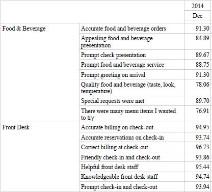

I've taken a screenshot of the output.
What I want to do is generate an average score for Food & Beverage, and then generate an average score for Front Desk. I then want to take those two averages and calculate an overall average for the survey.
What is happening is BIRT is generating the average by taking the sum of the scores of the 15 questions and dividing by 15 instead of just the two averages.

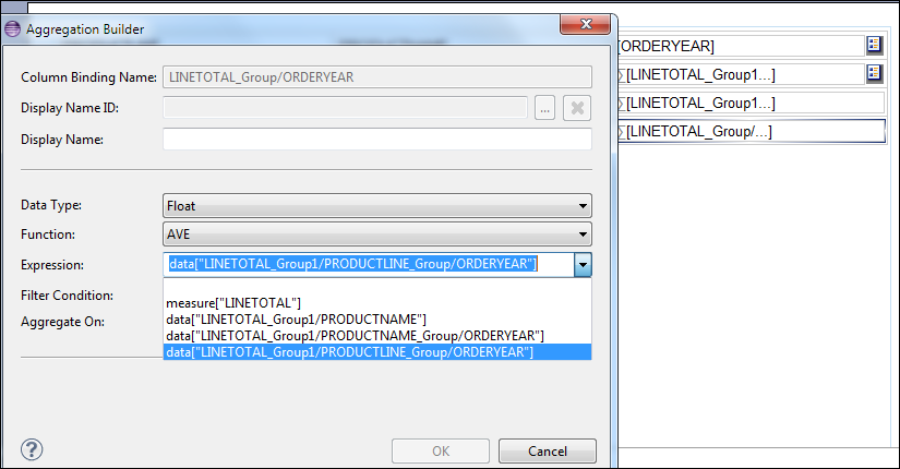

All you should need to do is select the correct measure grouping to aggregate over in your grand total aggregation expression. Take a look at the attached image.
