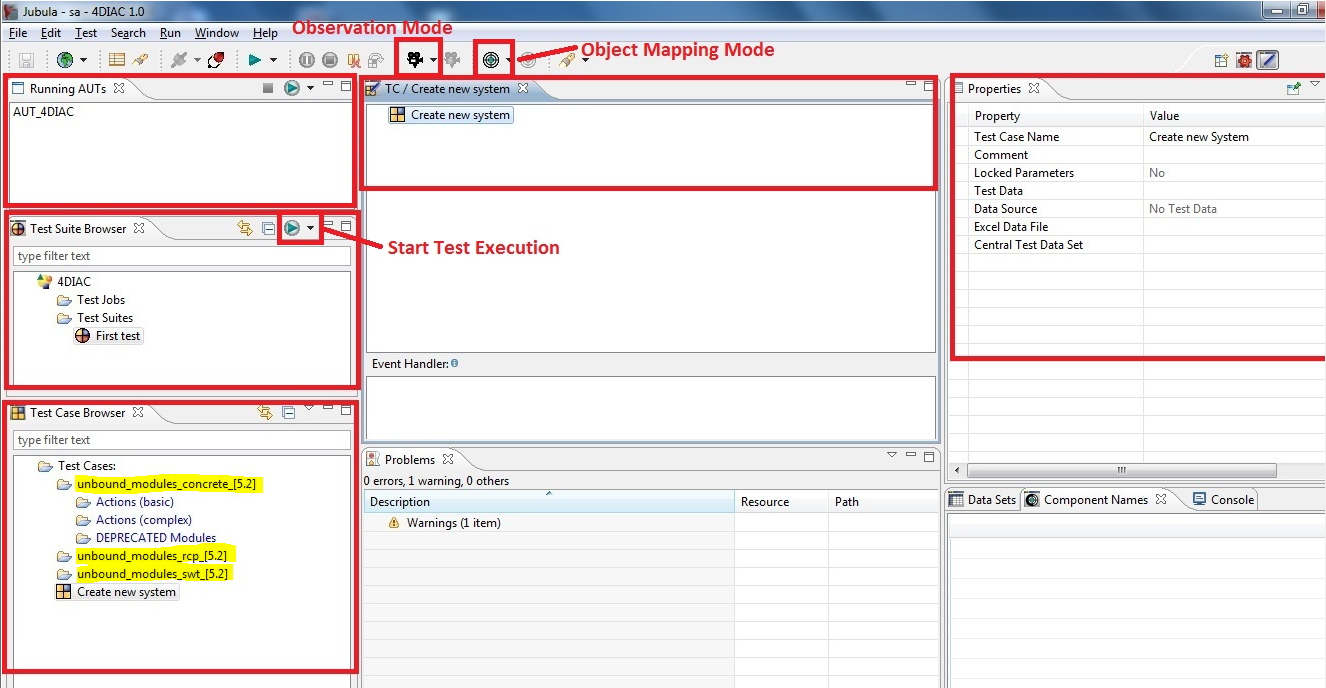

In the past my Test Case Browser always looked like this. All the unbound_modules are together inside the Test Case Browser.
index.php/fa/20883/0/

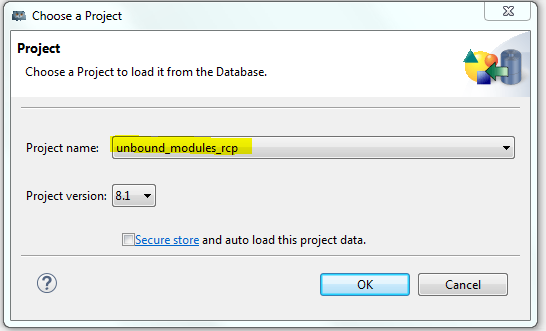

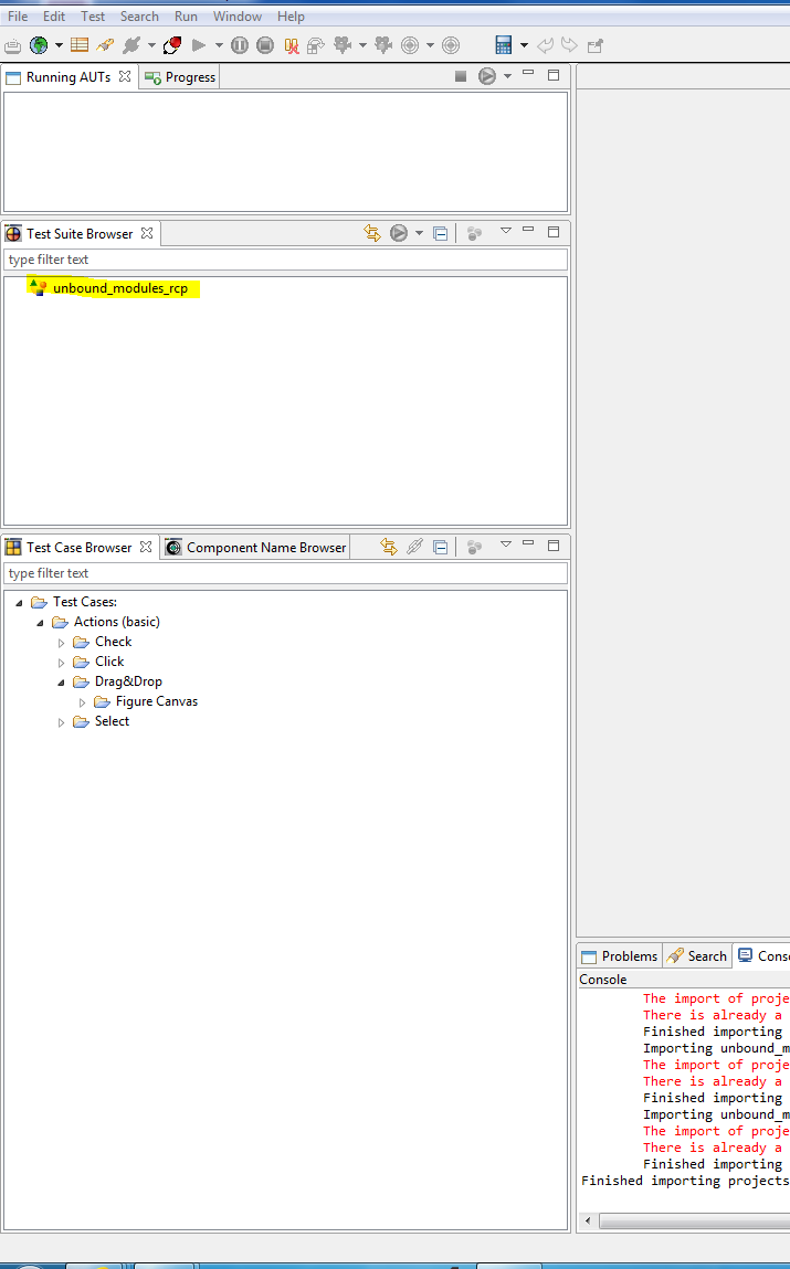

With the new installation I only came this far. Here only the actions of unbound_models_rcp are available.
index.php/fa/20886/0/
unbound_models_rcp was loaded from the database like a project. Before I always had access to unbound_modules rcp/concrete/swt via the Test Case Browser within all projects.

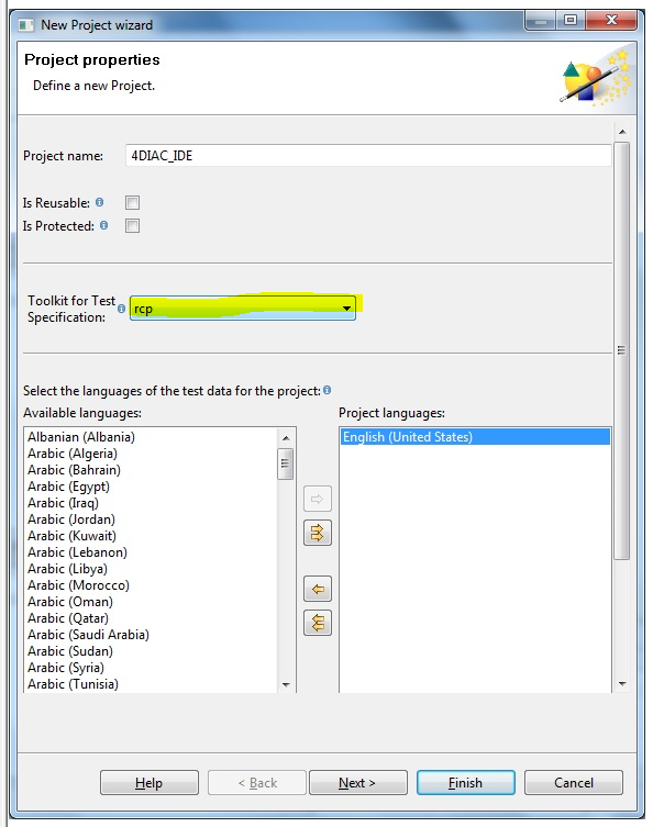

I use Jubula to test an application called 4DIAC. In the paragraph about testing 4DIAC with Jubula on the 4DIAC help page,
http://fordiac.sourceforge.net/ehelp/
I was instructed to choose rcp at any given opportunity
index.php/fa/20887/0/

Thanks for the images! It sounds like you got it fixed, but I'm unsure whether you've chosen the correct way. Here are my answers:
- In the first image, you have opened one of the library projects themself, not a project of your own that reuses the library projects.
- The answer is to find the project that contains your actual tests and to ensure that it it set to RCP in the project properties (or create a completely new project if that is what you're planning on doing). Then you can set the reused projects in the project properties.
If you can directly edit the items in the unbound modules, then you are working directly in an unbound modules project. This isn't a good idea because you won't profit from updates to them (you'll be working on your own copy).
