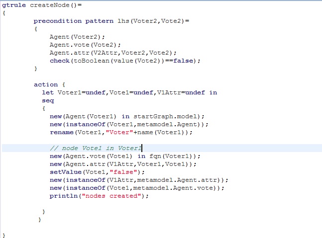

Hi all,
I am having an error to execute the bellow code, it gives this error.
The transformation encountered an error: Entity excepted as the Container parameter of the ElementCreateRule rule instead of String. (see the Error Log view for details)
The error happens when I create Vote1 as an attribute inside element Voter1:
new(Agent.vote(Vote1) in fqn(Voter1));
It executes only to creates the Voter1, but not the rest (Vote1, and the relations).
When I change fqn() to:
new(Agent.vote(Vote1) in startGraph.model.Voter1);
the problem is :
- Model element constant 'startGraph.model.Voter1' is non-existing in the model space.
index.php/fa/20327/0/

I guess the problematic line is " new(Agent.vote(Vote1) in fqn(Voter1)); " where the fqn function returns a string, but the new operation expects a model element (as described by the error message you have seen).
I have not tried it, but I guess, simply removing the fqn call would work, as follows:
new(Agent.vote(Vote1) in Voter1);

Hi Zoltan,
Thanks for the reply. Now it works.
