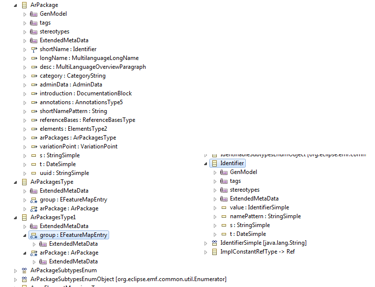

I'll try to explain, hopefully with simple words.
Approx 2 years ago I was using Xpand in combination with ECore transition from XML Schema (XSD). This was done dynamically, no persistent storage. (I used the org.eclipse.xtend.typesystem.xsd.XSDMetaModel class to do so).
The schema I used was pretty complex (AutoSAR v3.0.2), but it worked in an instant.
The usual workflow was like
* Go through objects
* Get the references
* Find the reference of interest
* Retrieve the EType
* Filter the attributes/elements
* Use "eGet( elements ) to retrieve the value of interest
So, this was working pretty fine. A few days ago I wanted to do the same as before. Got me the an AR 4.0.3 XSD, set up the project as before. It worked at first, until something strange happened.
The "eGet( attrib )" does not work on sub-elements anymore.
This, for example, works on the top level elements without a problem
EList<EAttribute> lstAttr;
		if ( eObj instanceof EClass ) {
			lstAttr = ((EClass) eObj).getEAttributes();
		} else {
			lstAttr = eObj.eClass().getEAttributes();
		try {
			for ( EAttribute eAttrObj : lstAttr ) {
					System.out.println( eAttrObj.getName() + ": " + ((EClass)eObj).eGet( eAttrObj ) );
				} else {
					System.out.println( eAttrObj.getName() + ": " + eObj.eGet( eAttrObj ) );
		} catch ( Exception e ) {
			e.printStackTrace();
However, going deeper into the structure, it spits out an exception like
"The feature 'shortName' is not a valid feature" (example based on the Tag "shortName" which is mapped in eCore as attribute.
index.php/fa/20204/0/
Well, since I first try to figure out what's going wrong I sat here two days single stepping and trying different access methods and files.
I found out that in deeper nested elements following statement became true
EClass MyClassObj = eRefObjArPckgs.getEReferenceType();
MyClassObj.getEAllAttributes() != MyClassObj.eClass().getEAllAttributes()
So, even if I find an specific attribute (EStructualFeature), this is not found in the "sub-class" .eClass() !
eClassArPckg.getEAllAttributes(): [org.eclipse.emf.ecore.impl.EAttributeImpl@35059fcd (name: shortName) (ordered: true, unique: true, lowerBound: 1, upperBound: 1) (changeable: true, volatile: false, transient: false, defaultValueLiteral: null, unsettable: false, derived: false) (iD: false), org.eclipse.emf.ecore.impl.EAttributeImpl@13a6ac2e (name: category) (ordered: true, unique: true, lowerBound: 0, upperBound: 1) (changeable: true, volatile: false, transient: false, defaultValueLiteral: null, unsettable: false, derived: false) (iD: false), org.eclipse.emf.ecore.impl.EAttributeImpl@38e711a6 (name: s) (ordered: true, unique: true, lowerBound: 0, upperBound: 1) (changeable: true, volatile: false, transient: false, defaultValueLiteral: null, unsettable: false, derived: false) (iD: false), org.eclipse.emf.ecore.impl.EAttributeImpl@2dbf1522 (name: t) (ordered: true, unique: true, lowerBound: 0, upperBound: 1) (changeable: true, volatile: false, transient: false, defaultValueLiteral: null, unsettable: false, derived: false) (iD: false), org.eclipse.emf.ecore.impl.EAttributeImpl@6fd99ff4 (name: uuid) (ordered: true, unique: true, lowerBound: 0, upperBound: 1) (changeable: true, volatile: false, transient: false, defaultValueLiteral: null, unsettable: false, derived: false) (iD: false)]
eClassArPckg.eClass().getEAllAttributes(): [org.eclipse.emf.ecore.impl.EAttributeImpl@31ef45e3 (name: name) (ordered: true, unique: true, lowerBound: 0, upperBound: 1) (changeable: true, volatile: false, transient: false, defaultValueLiteral: null, unsettable: false, derived: false) (iD: false), org.eclipse.emf.ecore.impl.EAttributeImpl@6adede5 (name: instanceClassName) (ordered: true, unique: true, lowerBound: 0, upperBound: 1) (changeable: true, volatile: true, transient: false, defaultValueLiteral: null, unsettable: true, derived: false) (iD: false), org.eclipse.emf.ecore.impl.EAttributeImpl@2d928643 (name: instanceClass) (ordered: true, unique: true, lowerBound: 0, upperBound: 1) (changeable: false, volatile: true, transient: true, defaultValueLiteral: null, unsettable: false, derived: true) (iD: false), org.eclipse.emf.ecore.impl.EAttributeImpl@5025a98f (name: defaultValue) (ordered: true, unique: true, lowerBound: 0, upperBound: 1) (changeable: false, volatile: true, transient: true, defaultValueLiteral: null, unsettable: false, derived: true) (iD: false), org.eclipse.emf.ecore.impl.EAttributeImpl@49993335 (name: instanceTypeName) (ordered: true, unique: true, lowerBound: 0, upperBound: 1) (changeable: true, volatile: true, transient: false, defaultValueLiteral: null, unsettable: true, derived: false) (iD: false), org.eclipse.emf.ecore.impl.EAttributeImpl@20322d26 (name: abstract) (ordered: true, unique: true, lowerBound: 0, upperBound: 1) (changeable: true, volatile: false, transient: false, defaultValueLiteral: null, unsettable: false, derived: false) (iD: false), org.eclipse.emf.ecore.impl.EAttributeImpl@192b07fd (name: interface) (ordered: true, unique: true, lowerBound: 0, upperBound: 1) (changeable: true, volatile: false, transient: false, defaultValueLiteral: null, unsettable: false, derived: false) (iD: false)]
So, why is that a problem?
The .eGet() does some evaluation which basically fails in certain points due to trying to find the feature behind .eClass() .
When, for example, I do
this.m_ModelMetaData.getElement(eClssArrPckg, ArXml4SchemaUrl, "SHORT-NAME")
I get the same as from the Attribute-List of the class which is not behind .eClass(). Thus leading to an exception as well when invoking eGet(). But I verified that my package registry is basically correct.
To make things even more absurd I tried to access the elements directly with a XPand template, using the previously stated XSD MetaModel class
«DEFINE Root FOR  autosar403::Autosar»
«FILE "Debug.txt"»
«FOREACH this.arPackages.arPackage AS arPackage»
	«EXPAND ArPackageShortName FOR arPackage»
«ENDFOREACH»
«ENDFILE»
«ENDDEFINE»
«DEFINE ArPackageShortName FOR autosar403::ArPackage»
	ArPackage: «this.shortName.value»
	«ENDFOREACH»
«ENDDEFINE»
Guess what?! It was working!
I verified all this strange behavior even with AR 3.2.1 XSD, so it's not a schema fault here...
So, basically my question is, does someone know how to resolve that strange problem? I need to access several attributes to get their values and the eGet() method seems to be the only one to do that.
Is a possible fix to be done within "org.eclipse.xtend.typesystem.xsd.XSDMetaModel" or in the EMF itself or should the EPackageRegistery be post-processed (HOW?)?
At least something must have changed on the internals on either one in the past two years...
Looking forward to some kind replies.
Thanks in advance!
  • Attachment: ArMapping.png
    (Size: 33.62KB, Downloaded 325 times)

Rony,
Comments below.
On 11/12/2014 5:48 PM, Rony Liemmukda wrote:
> Hi,
Note that I cannot comment on xtend?
> } else {
Keep in mind there's a very significant difference between
getEAttributes and getEAllAttributes and if you're using these for
reflections
> try {
Somehow this case makes no sense to me at all. If eObj is an EClass
and you get its eAttributes, you cannot use eObject.eGet() for one of
those attributes; it's the wrong meta-level...
> } else {
So certainly that wouldn't surprise me in cases where eObj is an EClass;
that just looks bogus as I said above.
I expect this is generally true. Again there in some total meta-level
confusion. Consider Java and you have some Class<?> x and you look
at x.getFields(), surely you'd not expect that x.getClass().getFields()
(which is just Class.class.getFields()) would have the same fields
(except when x == Class.class)....
Now my brain totally hurts. You should focus on traversing an instance
model and not mix the meta and the instances up the way you're showing
above. It's completely nonsensical.
> «FILE "Debug.txt"»
> «ENDFOREACH»
> «ENDFILE»
> «ENDDEFINE»
> «ENDFOREACH»
> «ENDDEFINE»
Yes, and your generally pattern should be to visit some EObject x, to use
for (EStructuralFeature f : x.eClass().getEAllStructuralFeatures)
x.eGet(f);
No checking if x is an instance of an EClass and other bizzare stuff
like I see above. And being careful to use
eAllAttributes/eAllReferences/eAllStructuralFeatures so you visit all
attributes/references/features and not just the locally declared ones.
I don't get how the code you showed ever worked. Perhaps the newer
schemas make better use of inheritance for sharing common structure so
you eAttributes no longer visits all the data properly.
> Thanks in advance!
Ed Merks
Professional Support: https://www.macromodeling.com/

NOW it just came to my mind like a nail to a magnet....!!!! I probably used that EReference feature directly instead of putting it into eGet() as parameter.. Let me check that to confirm my stupidity... before you provide another answer...
[Updated on: Thu, 11 December 2014 21:22]
Report message to a moderator
Re: XSD -&gt; ECore; internal missmatch (auto-creation) [message #1508228 is a reply to message #1507627] Fri, 12 December 2014 08:14 Go to previous messageGo to next message
Rony Liemmukda is currently offline Rony LiemmukdaFriend
Messages: 6
Registered: December 2014
Junior Member
Hi Ed,
me again with some positive results Smile ... I'm partly an idiot, since in the upper functions (I use specific functions for each type to keep the "garbage" low and the code specific to the element) I did it as you described but deviated in the sub-sequential ones (I'll change the code to be more generic and central instead of copy/pasting parts across functions to avoid that in the future).
Anyhow, correcting that led me to another occurrence from which I think led me to this deviation. The returned object was a FeatureEList; guess I was thinking that I did something wrong and tried another approach. So, a total fail on my part :/ (At least I'm 98% sure that I never saw a FeatureEList two years ago...)
Eventually, if you can confirm me the following approach to be a correct handling for that type of object, it would give me further confidence.
Very much thanks for the nudge in the right direction! I know that I did something terribly wrong, but I couldn't figure out what...
		/* we want to have an Arpackage*/
		for ( EStructuralFeature eObjFeat : eCoreObj.eClass().getEAllStructuralFeatures() )  {
			if ( EArxmlFeatures.ARPACKAGE.toString().equals(eObjFeat.getName())) {
				Object arPackageObj = eCoreObj.eGet(eObjFeat);
				if ( arPackageObj instanceof List<?> ) {
					@SuppressWarnings("unchecked")
					FeatureEList<EObject> arPackage = (FeatureEList<EObject>) arPackageObj;
					/* I don't want to hard code get(0) */
					for ( EObject eFeatListObj : arPackage ) {
						parseArPackage( eFeatListObj );
				} else {
					/* it must be an EObject, not a List<EObject> */
					parseArPackage( (EObject) arPackageObj );
			} else {

That might well be. They're kind of ugly and arise from kind of ugly
aspects of XML Schema....

You can't make this general assumption that if it's a list is must be a
feature map. You can use
org.eclipse.emf.ecore.util.FeatureMapUtil.isFeatureMap(EStructuralFeature)
to test if a feature represents a feature map. But the whole code looks
a little suspect. It's not clear if this is only supposed to work for
arpackage instances or not. Otherwise it's all kind of arbitrary, i.e.,
if the object happens to have a feature with some specific name, you'll
going start making assumptions about it...
Well, that was my assumption... BUT it didn't work

I think I can explain that in three sentences as well.
I am not getting a FeatureMap for that structural element, instead I am getting its inner class FeatureEList. That is why I check for a list instance. It might be the previously mentioned helper class which does this "deviation".
I saw from your link, your article, that you eventually/usually retrieve a FeatureMap for the kind of elements I am evaluating (which you try me to tell to take care of as well?!).
I see. Don't read to much information into the specific implementation
classes. It's a little like observing in the debugger that you're
working with a LinkedList verses an ArrayList, but in the end you only
need to be considered (typically) it it's a List. So check things like
feature.isMany and if that's true, you can definite cast to List.
> retrieve a FeatureMap for the kind of elements I am evaluating.
Feature maps arise in many occasions and you can use
FeatureMapUtil.isFeatureMap to test for this.
