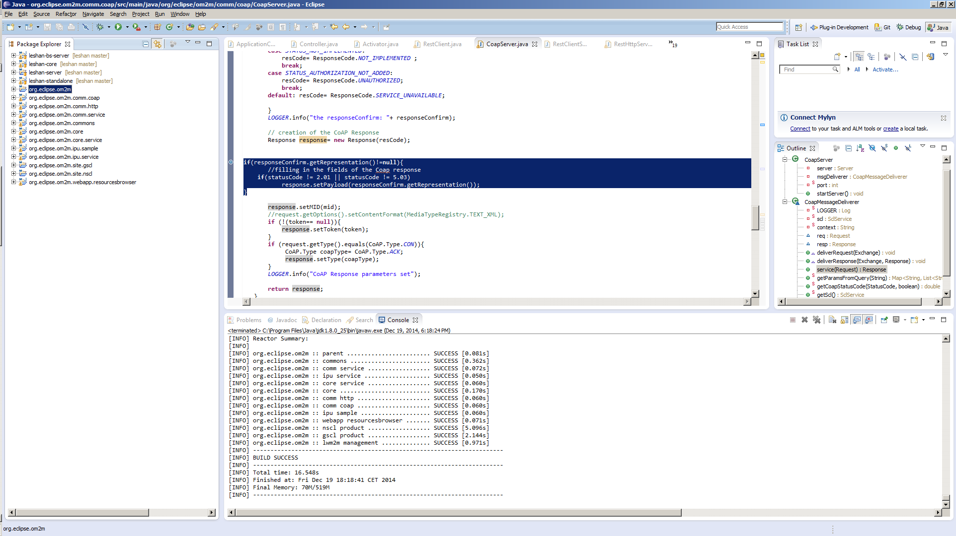

Re: Using CoAP based applications (Copper vs Erbium) [message #1516143 is a reply to message #1516129] Thu, 18 December 2014 12:39 Go to previous messageGo to next message
I think that returning the representation of the created resource is useless in constraint environment.
So I suggest you to go to "org.eclipse.om2m.comm.coap" plugin and update the "CoapServer.java".
Update the following code (line 242) :
if(responseConfirm.getRepresentation()!=null){
           //filling in the fields of the Coap response
    	   response.setPayload(responseConfirm.getRepresentation());
like this:
      if(statusCode != 2.01){
Tell me is this update meets your need.
If yes, I will push a patch to the git.
cheers
[Updated on: Thu, 18 December 2014 12:40] by Moderator
Re: Using CoAP based applications (Copper vs Erbium) [message #1517551 is a reply to message #1516143] Fri, 19 December 2014 10:31 Go to previous messageGo to next message
hallo,
I added that condition and the result was the same. The first message of the response to application registration is still 584bytes long (on the wire) with [Block2: NUM:0, M:8, SZX:512] header. I looked for this default response size even in 'Californium' but without success.

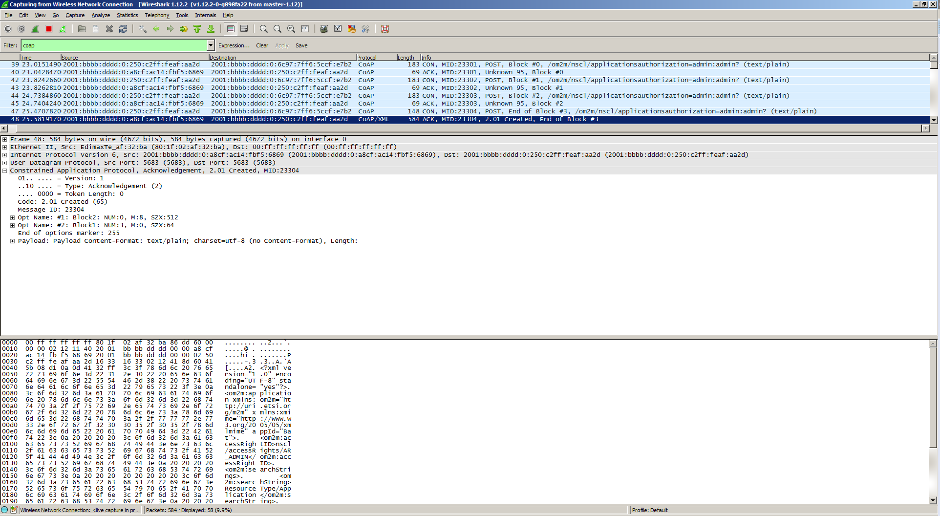

Re: Using CoAP based applications (Copper vs Erbium) [message #1517677 is a reply to message #1517560] Fri, 19 December 2014 12:22 Go to previous messageGo to next message
Yea I've done that. I also tried to add the 'protocol' query in the OM2M code if it could help, but it does not have change. Previously the protocol is always shown as null, whether set or unset in requests. I actually talked about this to let you know that I can actually see the effect of the changes I make to the code.
Look at the attached pics.
  • Attachment: OM2M.png
    (Size: 146.41KB, Downloaded 693 times)
  • Attachment: CoAP POST.png
    (Size: 127.42KB, Downloaded 695 times)
Re: Using CoAP based applications (Copper vs Erbium) [message #1517683 is a reply to message #1517677] Fri, 19 December 2014 12:25 Go to previous messageGo to next message
The problem is clear here, you must use && instead of || in your if condition like this:
       if(statusCode != 2.01 && statusCode != 5.03 ){

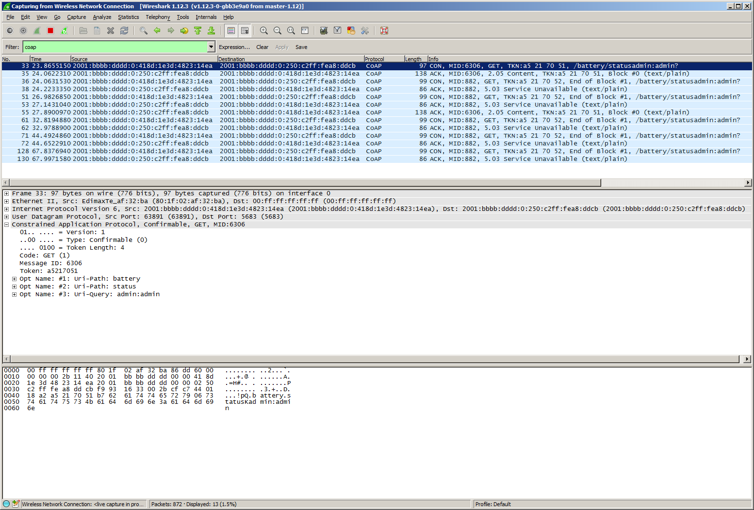

Re: Using CoAP based applications (Copper vs Erbium) [message #1585895 is a reply to message #1524448] Mon, 26 January 2015 09:51 Go to previous messageGo to next message
hello guys,
Have you noticed a problem on the CoAP message deliverer during block wise transfer?
The situation is like this, an Application sends a request to the NSCL to get a resource of an already registered application (DA). By default the NSCL sends (forwards) a request without setting any CoAP block headers. But the response from the DA holds BLOCK2 header. The message id should be continuous in this case and the NSCL should continue with an incremented mid and the new BLOCK2 header. But the message id jumps to some new random value which makes it difficult for the other side (DA). Take a look at the attached Wireshark screen shot.
Any suggestions?
Re: Using CoAP based applications (Copper vs Erbium) [message #1597821 is a reply to message #1585895] Mon, 02 February 2015 10:32 Go to previous messageGo to next message
Hello Fesseha,
What i see from the wireshark log is that there is a GET request which is divided in 2 blocks (block 0 and block 1). The error message is a SERVICE UNAVAILABLE (5.03). This means that all the blocks have been assembled but there is no service to respond to the GET request. I don't think there is an issue with the blockwise operation here. However to make sure of this, you should investigate a little deeper and be sure that the request is assembled correctly. i strongly believe it is not the CoAP client problem and you should see in the service part and check if it is available and why it is not responding.
Mahdi & Elvis

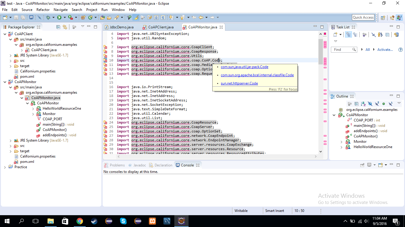

Re: Using CoAP based applications (Copper vs Erbium) [message #1742555 is a reply to message #1741634] Mon, 05 September 2016 02:11 Go to previous messageGo to next message
Hi Son Duong,
Thank you alot for helping me out earlier. I downloaded the files and imported it to Eclipse neon (this is a separate eclipse ide which does not deal with OM2M project at all). Attached with reply is an image please have a look and guide.
Thank you for your help.
  • Attachment: Untitled.png
    (Size: 140.28KB, Downloaded 550 times)
Re: Using CoAP based applications (Copper vs Erbium) [message #1742562 is a reply to message #1742555] Mon, 05 September 2016 04:23 Go to previous messageGo to next message
Hi Muhammad,
I think you miss the californium libraries. You can download them here: https://mvnrepository.com/artifact/org.eclipse.californium/californium-core and here https://mvnrepository.com/artifact/org.eclipse.californium/element-connector . After downloading, just add them to your project and everything will work fine again.
Son

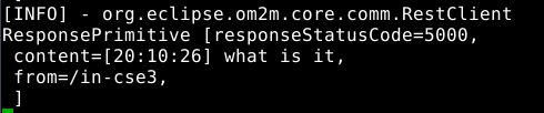

Re: Using CoAP based applications (Copper vs Erbium) [message #1743381 is a reply to message #1742562] Wed, 14 September 2016 14:19 Go to previous messageGo to next message
Hi all,
I'm trying to apply CoAP into the subscribe/notify scenario with sensor create value and send to the actuator. I did with Http and it works normally; however, when I apply the coap monitor in the actuator, the actuator receives the value from sensor but the Response Status code in sensor console is 5000. I use the CoAPMonitor which provided above. Anyone has solution for this? Thanks in advanced!!
Re: Using CoAP based applications (Copper vs Erbium) [message #1743578 is a reply to message #1743381] Fri, 16 September 2016 10:05 Go to previous messageGo to next message
Hi Trung Luu,
the 5000 response is probably due to an incorrect return coap code. In the HTTP monitor.jar, the application returns a response code 204 (no content). I didn't find a suitable corresponding code for the coap protocol, so I returned a hardcoded string, which is incorrect.

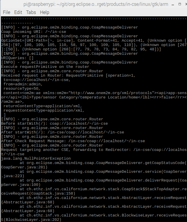

Re: Using CoAP based applications (Copper vs Erbium) [message #1786289 is a reply to message #1741005] Sun, 29 April 2018 20:46 Go to previous messageGo to next message
Hi Klemen Petrovcic.
First of all, thank you for uploading the sample application.
I tried to send CoAP message using your application. but null pointer exception appeared like a picture i uploaded when any message arrived to IN-CSE. so your application tried to send again but after time to live, it closed without explicit answer message.
how do i miss it?
  • Attachment: nullerror.png
    (Size: 79.36KB, Downloaded 258 times)
Re: Using CoAP based applications (Copper vs Erbium) [message #1786747 is a reply to message #1786289] Thu, 10 May 2018 10:33 Go to previous messageGo to next message
Hi Soyong Kim, do you already know how to solve it?
Re: Using CoAP based applications (Copper vs Erbium) [message #1787502 is a reply to message #1786747] Sun, 27 May 2018 08:38 Go to previous message
Hi Paulo
i solved the problem by modifying CoAPServer class in OM2M source code
i think the problem was "to=coap://localhost/~/in-cse" in the picture i uploaded.
so i modified requestPrimitive.setTo(request.getURI())
to request.Primivice.setTo(request.getOptions().getURIString()) in CoAPServer class
I think this way is not good,
but i don't know how do i solve the problem without modifying the code..
if anyone knows any other way, let me know.
  • Attachment: null.png
    (Size: 83.73KB, Downloaded 235 times)
