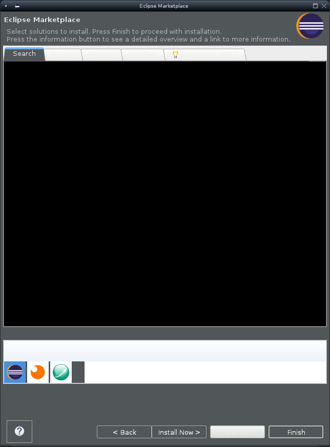

This happens on Luna and Mars but works on Kepler. So I'm stuck on Kepler and can't move forward to newer versions. OS is Fedora 15 and I'm pretty much stuck with that. Happens on all themes. White text on gray buttons and tabs is also hard to see, how to change?

A couple of questions: I assume this is Gnome 3? Could you please verify if this also happens when running Eclipse without GTK3 support? To do that, set the environment variable SWT_GTK3=0 before starting eclipse:
export SWT_GTK3=0
./eclipse
I assume with themes you are referring to Eclipse themes, not Gnome themes? Do you have the white text on gray buttons with all themes? And is this limited to MPC or is it the same across Eclipse? We are using the default SWT/Eclipse UI colors, so you should get the same colors in MPC as in the rest of Eclipse. I know that as of yet, not all Eclipse UI elements are fully theme-able, which is especially obvious with the dark theme.
