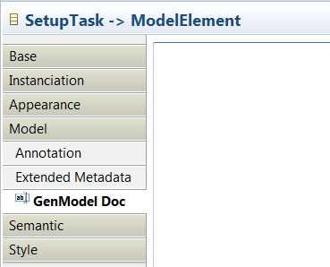

I'd expect to see a tab like this:
You're using the latest Ecore Tools editor?

I think I have to post as HTML from Thunderbird for the diagram to
come out:<br>
<br>
<img src="https://www.eclipse.org/forums/index.php?t=getfile&amp;id=19545" alt=""><br>

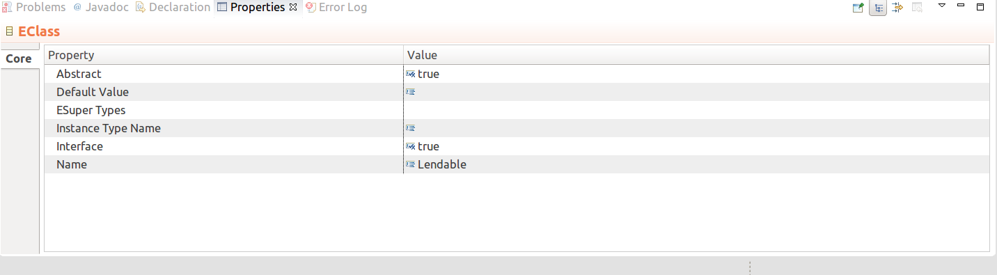

I'm using the latest Luna download.  I went to Help &gt; Install
Modeling Components and selected Ecore Tools.  After the install, I
right clicked the ecore model and created the corresponding
ecore_diagram model.  The tabs look like this:<br>
<br>
<img alt="image" src="https://www.eclipse.org/forums/index.php?t=getfile&amp;id=19564"
height="395" width="1432"><br>
<br>
I'll answer the second half in different email, in case my markup is
throwing off thunderbird.<br>
